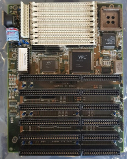

Reply 8 of 21, by Marco
I checked the board and the picture of the page you mentioned. But I have no clue where I should or better where I could put in additional caps.
Would you mind to highlight the spots on the picture? I checked the pins but don’t know where there to add them. 🙁
Thanks a lot really upfront.

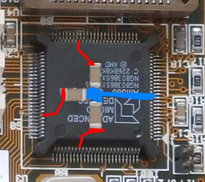

Reply 9 of 21, by Marco
Ok I think you mean these for the cpu.
„ 220uF electrolytics/tantalums and 100nF on 5V near last ISA slot and near CPU“
Im not sure which capacities to put where exactly. Is this something you further go in detail ?

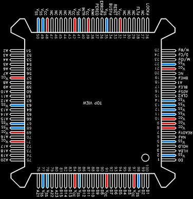

Reply 10 of 21, by nocash
Fully stable doesn't neccessarily mean that it was more than 0.0001% away from unstable.
If it's related to capacitors, and as you have swapped and removed all cards (which do contain capacitors themselves), maybe it works better if you move this or that card closest to the cpu.
Reply 11 of 21, by rasz_pl
Here is CPU pinout.
20.54 KiB
557 views
Red is +, blue -. Ideally you would glue like three or seven 100nF ceramic capacitors on top of the CPU in a star pattern all connected to each other on one end. Wire that center to ground on the motherboard (any blue pin), and connect left over capacitor ends to red pins of cpu with thin wires distributing capacitors around ignoring 8-14 pins as there is already one cap there. something like this:
43.34 KiB
557 views
+ one ~100-680 uF electrolytic on top of all this for good measure between any blue/red :]
Without putting scope on this board I give 0 warranty that CPU voltage fluctuations are your main issue, but more decoupling never hurts.
