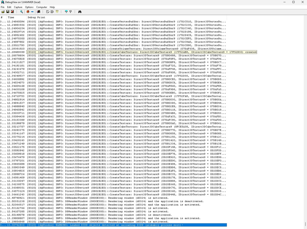

Loading a savegame I got a segmentation fault error and this is the debugview trace, with 2.84:
Menu (it's a map too) is working.
