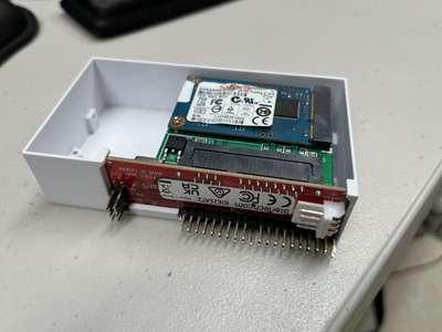

Reply 42 of 102, by douglar
oh2ftu wrote on 2024-12-27, 15:01:
has anyone encountered a suitable 2,5"->3,5" print with a "slot" for the startech ide2sat2-adapter?
I just got a 3d-printer, but I'm at loss with fusion360.
I did this for an Msata device.
https://www.tinkercad.com/things/dIGRnd9BlWk- … a-to-35-marvell
1.21 MiB
643 views
Maybe you could use that as a starting point and combine it with this?
https://www.tinkercad.com/things/k9WQeCkhbz1- … 5-to-35-adapter

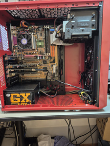

Reply 43 of 102, by douglar

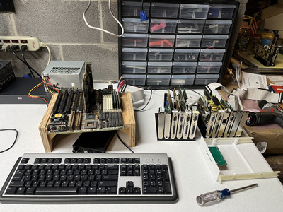

Major Jackyl wrote on 2024-12-27, 01:44:
Wow, those look great, nice work! I have a few ideas, but have been too busy to work on it. I've made single card displays for PCI, AGP, PCI-E, and SLOT1/A. I haven't finalized them to my satisfaction yet. I want a fan header(s) on the Slot1/A stand and the AGP on is a bit loose since the slot is small.
I'm just trying to clean up my desk. So far so good!
1.81 MiB
618 views

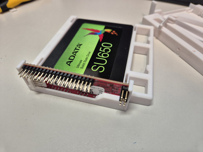

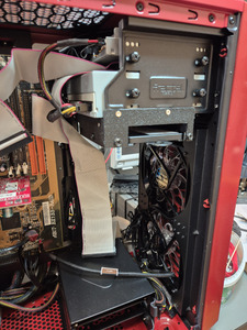

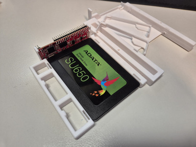

Reply 46 of 102, by oh2ftu

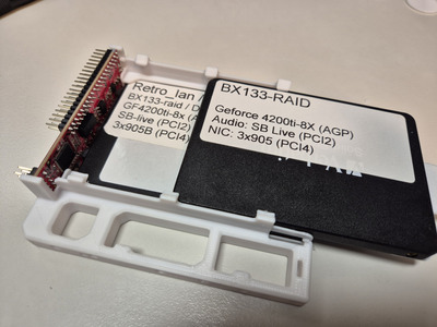

This is my first item I designed myself with fusion.
I used @douglar work for the ide2sat2 slot and modified it quite a bit.
I have yet to reprint it with looser nubs for ssd-mounting holes, and it will also have floppydrive-matched holes so it can be installed as a floppydrive as well. A facia might be needed..
Fusion took a while to get a hang of, I keep looking for ACAD-features, as I've used ACAD at work (electrical design) for 15 years 😀
1.54 MiB
573 views
1.65 MiB
573 views

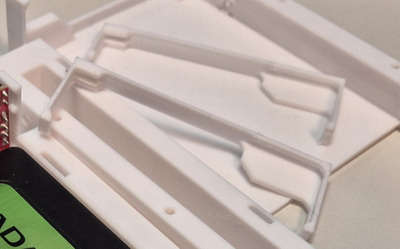

Reply 47 of 102, by douglar
oh2ftu wrote on 2024-12-29, 18:11:
I like the design. What's it look like with the clips on? What kind of build is it going in? PIO? MWDMA? UDMA?
I have not used Fusion. I use tinkercad and export an STL. I used to send it off to my public library to print, but now I import into Creality Print and create a gcode file for the printer.
Reply 49 of 102, by douglar
oh2ftu wrote on 2024-12-30, 08:40:
I have multiple systems so I will be printing quite a few of these (maybe eight?).
What clips did you mean? 😀
Getting bridged sata devices to do MWDMA transfers can be a challenge. IDE contollers that do MWDMA but not UDMA are late 486 controllers like the CMD640 and PDC20630 up through the PIIX3 pentium south bridge from intel. Mostly systems that would have shipped with Windows 95. You can always fall back to the PIO modes.
These were the clips I was talking about:
47.99 KiB
519 views

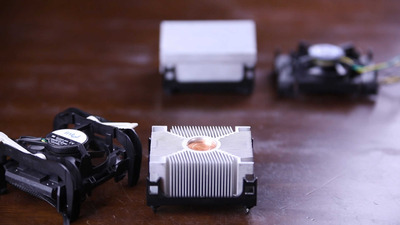

Reply 51 of 102, by khyypio

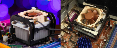

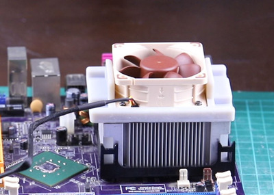

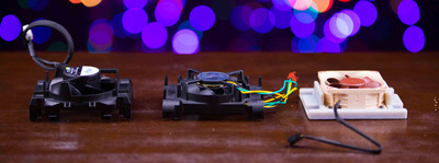

Hello!

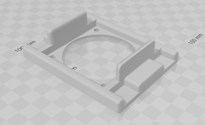

Got a tip this thread. This is an adapter that you can use to install a 60 mm fan to stock Intel socket 478 cooling assembly.
125.49 KiB
472 views
34.33 KiB
472 views
226.13 KiB
472 views
84.96 KiB
472 views
283.59 KiB
472 views
A video: https://youtu.be/xkzoRT0c4uE
Download: https://www.thingiverse.com/thing:6879228
Reply 52 of 102, by douglar

Reply 53 of 102, by oh2ftu
Ok, so after a few attempts it seems quite ready. The mount itself is still a little flawed, but I'm waiting for better filament before a reprint.
These are not available on printables (yet) but at some point they will be.
The SSD-adapter will hold a Startech-adapter with one drive connected. Another drive can be slotted in above it.
Only 7mm drives supported, but it's easily modified to take just one taller drive.
It has 3,5" dimensions with holes for 6-32UNC with HDD-spacing, as well as M3 holes with floppydrive-spacing. There's a faceplate that should fit a floppy slot too.
The side and front which accomodate mounting to the Fractal design Focus G case are screwed with 6-32UNC screws (also snap-on fitment). The front facia mounting also has slots for M3 square nuts if you prefer M3 countersunk screws.
Reply 54 of 102, by red_avatar
khyypio wrote on 2025-01-02, 15:40:
Hello! […]
Hello!
Very nice!
As long as the heat sink doesn't go beyond 60-70°C the 3D print should hold without warping if PETG is used.

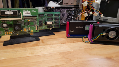

Reply 59 of 102, by aspiringnobody

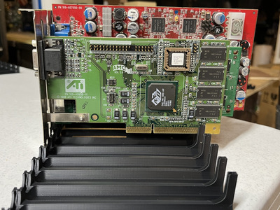

douglar wrote on 2025-01-16, 01:49:
I need a second draft. The AGP cards have that high cut at the end.
1.93 MiB
281 views
Looking good!
