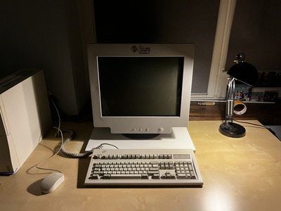

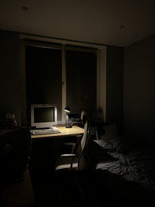

I've recently became a father and my long awaited dream of building a retro pc corner became more relevant - i want to play videogames of my childhood with my son. Not sure if he would dig it or not, but i decided to give it a shot 😁
The prices on retro hardware seem to be rising constantly, so i decided to begin this quest.
So this is my current build
1.45 MiB
1278 views
The base is IBM Personal Computer 330, model 6577 (last variation of 330 series)
CPU has been upgraded to Pentium 200 MMX (ceramic one)
144mb memory
Integrated GPU - s3 trio 64v+ , 1mb + 1mb upgrade
GPU accelerator is 3dfx Voodoo 1 4mb by Diamond Monster 3D
The monitor is Sun GDM-5510
The Keyboard - IBM Model M, dated 1988.

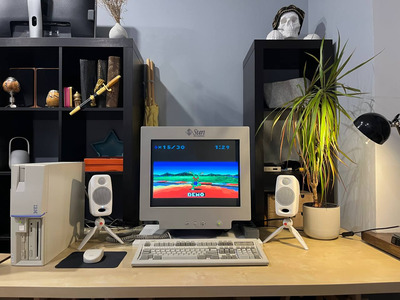

Hey everyone! Thank you guys for the soundcard suggestions! i've fiddled with some cheap half-dead OPTi card without success and decided to go with OII. Here's the update on my build as well as some issues i have atm
first of all, the looks:
The attachment photo_1_2025-02-22_20-19-46.jpg is no longer available
so the hardware updates are (unfortunately, i can't update the original post):
  • the most major one is, of course, the Orpheus II - i managed to buy one from the final batch. Very grateful to Leo for his responsiveness and kindness!
    new speakers - iLoud Micro Monitors (i know, they're not retro, but i just love the looks of them, especially with those white manfrotto tripods)
    Mt32-Mccake from Serdaco for WT MT-32 emulation
    nice slot loading CD-ROM - Pioneer DR-502S (made in Japan, made my first retrobrite process with it)
    CF to IDE adapter - StarTech 35BAYCF2IDE
    CF card #1 SanDisk Extreme Pro 32 GB for Windows 98 SE
    CF card #2 Transcend Industrial 8GB for DOS 6.22
Thought that OII gonna solve all my problems but of course it was not the case - I went into the rabbit hole of trying to befriend the OII with the cursed OEM nature of IBM PC.
long story short, by using the intel ICU utility I've managed to setup the OII in DOS 6.22 installation - at least the suggested by Leo Jazz Jackrabbit game works fine with GUS sound. I haven't been able to test other games though - except Tyrian, which didn't work with GUS ("couldn't initialize Gravis Ultrasound" in setup), but maybe I have the broken copy of the game.
the W98SE environment is much more problematic and took many hours of my life, and I still can't get it work properly. Through Intel ICU utility I've managed to appoint proper IRQ/DMAs to CS and GUS parts of the card, but I still observe many problems - whining sound from speakers, clicking sound when changing volume, and GUS part seem to not work in dos games running from windows - dos window just hangs when I try to select the GUS (for example, in Tomb Raider 3dfx voodoo demo).

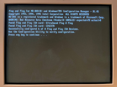

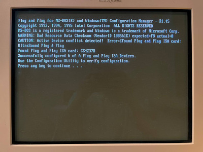

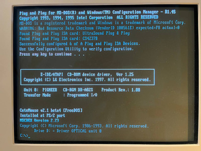

1. Device conflict error in ICU
first of all, i sometimes get "Active Device conflict" in intel ICU, for example when i boot the PC from previously disconnected power:
130.03 KiB
245 views
after the restart i usually don't have this issue (but sometimes i do, hence the randomness i mentioned earlier)
141.76 KiB
245 views
anyway, in both cases W98 shows no conflict, but the behavior of sound is still problematic, as i already said.

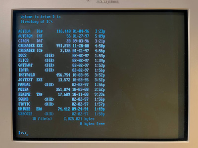

3. CD-ROM behavior
I have this very weird issue with my CD-ROM that I cant google. Whenever i boot into DOS and check the contents of inserted disk (by DIR command or from NC), i get gibberish letters in most of the filenames, so i cant run or copy anything from the Disk:

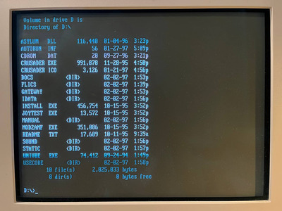

That is not the case when i boot DOS 7 from Windows side:

Interestingly, the problem is not with the filenames only, but goes further - for example, the GSCDROM.SYS driver shows the CD-ROM model when executed, and the gibberish letters display even there:

bogus characters on devices and files could mean some address conflict - if for example you have a mpu at port300 and you are using a xtide-cf interface again set in port300 you get completely bogus device name and listing if it happens to boot
tyrian needs "ultramid -c" to be ran prior to launching the game else gus support will not work , I believe this is stated in the help file of the game
I am not sure what could be wrong with the system, if you also had issues with other soundcards it might indicate some deeper problem... :\
