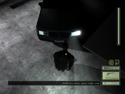

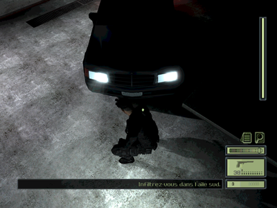

Hello,
I think I’ve found a bug in Splinter Cell related to some "volumetric" lighting effects. It seems that when two of these effects are supposed to appear at the same time, one of them gets cut off.
For example, in the Defense Ministry mission, when you have to interrogate the driver, there's a car that projects two spotlights, each supposed to produce a volumetric effect. However, when using dgVoodoo2, only one effect is displayed. Interestingly, if I destroy the light that does show its effect, the other one starts to work (see the screenshots I’ve attached).
I’m not sure this is a bug in the game itself, as I saw both effects working properly in this YouTube video: https://youtu.be/HDXgCL52HZw?t=1523
I’ve also attached a save file close to the car with both lights for easier testing.
Thanks!
Kevin

Hi,
Interesting rendering situation. I improved the GF4 emulation a bit in the latest dgv release, now both headlights are working.

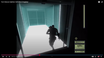

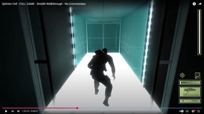

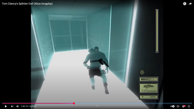

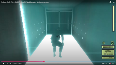

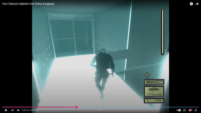

Good to know this game is still living breathing on PC thanks to the hard work of Dege and good folks here at vogons. I'm curious what files have been edited to remove the tiles shine in the CIA & Defense level fix by daniel_u ? Maybe if the specular that properly works on modern PC like on doors and wall tiles in CIA level could be applied to floors in these levels and that would make it look better.
Also I found one weird issue in the PC version compared to xbox in the CIA level. In the laser hallway in xbox, they cast a light and shadow on the wall and when you pass through it a nice effect is produced. In the PC version that shadow and light on wall is completely missing and the effect when you pass through it is partially produced at certain very close angles only.

Reply 253 of 264, by Joshhhuaaa
PimPom(SFG) wrote on 2025-04-23, 08:32:
I'm working on a small patch on this game and been trying to get the PC version closer to the Xbox, many of the downgrades are related to the developers updating the PC map file. I'll be including several Xbox map files in the patch but CIA HQ in particular is currently having issues with its textures on PC, so hopefully I can fix that.
I'm assuming this is what you are talking about?
There is still some stuff that either the PC version is missing entirely (like depth of field) or 640x480 might be necessary to get the proper effect.

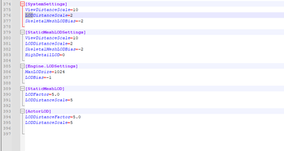

Oh my god! Yes! exactly this. You've managed to fix it and even fixed the PS3 textures. It looks absolutely beautiful. I personally tried fixing the ps3 character textures for Sam and other characters and simply removing alpha textures seem to fix the weird shadows but couldn't do it for everything. So thank you so much and Godspeed on your work. I can't wait for the patch. And yeah playing on 640x480 does fixes a lot of lighting mipmapping issues so hopefully your patch will also fix depth of field in nightvision.
Maybe too much but I've also tried increasing the LOD for characters as they seem to loose detail right in front of you, but adding these parameters doesn't really help much. I wonder what setting UE2 uses for character mesh lods.
    20.3 KiB
    181 views
    LOD increase test

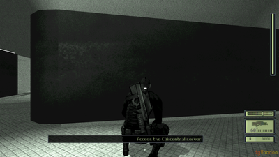

Reply 258 of 264, by PimPom(SFG)
Joshhhuaaa wrote on Yesterday, 09:34:
I just released that small patch I was working on here.
You can give it a try, and most of the maps will look much closer to their original Xbox version. I also added full Xbox controller support if interested in that. Unfortunately, I wasn’t able to include the Xbox CIA HQ yet because the specular materials aren’t rendering correctly. I didn’t think it was polished enough to add. Police Station (part 3) would have been nice to include for Xbox as well, but I couldn’t because of the same specular issue. I’ll attach the CIA HQ Xbox map file below so you can try it yourself, but I’m leaving it out of the patch for now.

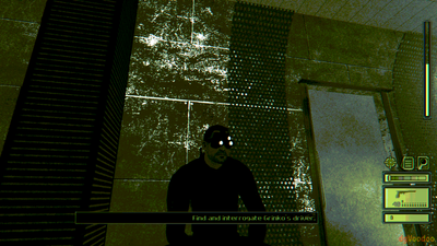

Man that was blazing fast! Thank you so much. I'm going to test it right now as I have saves for each area of each stage. And yeah about that specular issue, I noticed it is buggy even on the Xbox one enhanced version as well. So the best thing I could think of is replacing that shader (In the Defense ministry on the metal wall fence in the corridor, then in CIA floors and CIA main hall one) with a properly working shader ( the wall tiles in CIA HQ) and that would preserve the illusion without messing with the original specular shader. I'm attaching screens for reference here. Again brilliant work and thanks a ton for saving this beautiful game.
    423.26 KiB
    96 views
    Properly working wall tiles shader (CIA HQ)
    1.24 MiB
    96 views
    Buggy shader (defense & CIA)
    515.14 KiB
    96 views
    Buggy shaders (defense & CIA)

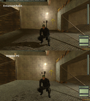

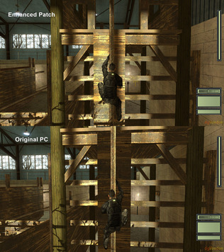

Reply 259 of 264, by PimPom(SFG)
Took a few comparison shots and I'm extremely happy. Right from the very start the difference is clearly visible. Never ever I knew in my playthroughs how much of a detail was missing in the PC version. No wonder why guards detected me, because the shadows were small and I thought how I'm visible. Definitely AI was tailored to match the xbox shadows and lighting. The stage saves aren't compatible but good thing is levels are unlocked from my saves so testing is easier. One more thing I noticed that in graphics options shadow detail is visible which isn't in my original version. Wonder why. All in all absolutely phenomenal work. This is definitely a must have patch. I'll do more testing in the meantime. Thanks again for everything.
Full Comparison Screenshots
https://imgur.com/a/m5HuGoh

    SC1 enhanced vs original 1
    709.92 KiB
    68 views
    SC1 enhanced vs original 2
