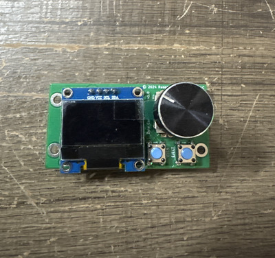

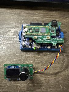

Reply 29 of 264, by mbalmer
Lostdotfish wrote on 2025-01-27, 10:13:
Yep, there it is - you posted it before I got around to it.
Just be aware that while the hardware interface is entirely functional as it exists, what's in that repo might not look like or even function similarly to the form the interface takes when it reaches release status. It's been reworked about three times before the version that's in that repo, and it's entirely possible that it'll get reworked again.
That said, suggestions on its function are absolutely welcome, and if you discover issues with it, please let us know.
The hardware interface, when assembled, is a board separate to the ZuluIDE and is attached directly to it via a Qwiic cable.
When assembling it, you only need to populate J6 (the Qwiic connector on the same side as the rotary encoder). J7 is there as a passthru for future I2C use if needed.

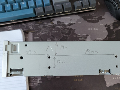

Just happened to have a NEC DVD/RW drive handy so have taken some measurements.
The drive faceplate (the bit that protrudes through the case) is
147mm x 42mm x 5mm
The drive dimensions where it mounts to the case rails are as follows;
146mm x 41mm
There are 2 pairs of mounting holes that are M2.5 (I believe but might be worth checking this)
Vertically the pairs are spaced 12mm apart centre to centre
Horizontally the 2 pairs are 79mm apart (c2c)
The top hole is 19mm from the top edge of the drive (edge to hole centre)
The first pair of holes are 52.5mm from the very front of the drive.
Total drive length should not matter for this application as long as you have enough length to fit the mounting holes in. I've attached a photo to try and clarify the mounting hole spacing.
