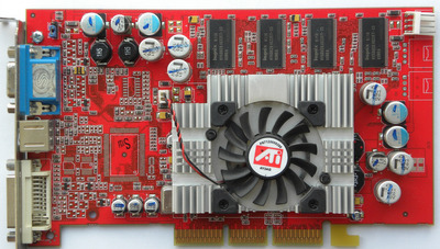

Could it be a modded 9800 SE ? This one from Palit uses a crazily similar board component layout along with similar ram and a 128 bit bus. This image is missing a few caps but you can see how the layout would be if they were present, the 9800SE used lower aulity parts, had similar clocks to this card but it used the R350 core.
357.76 KiB
986 views
Palit 9800 SE

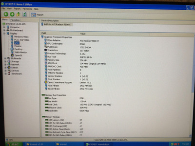

Reply 26 of 66, by zuldan
I ran Everest, here is the result.
931.93 KiB
540 views
Will remove the cooler and take pictures later today.

Memory clock is incorrect should be ~730Mhz effective, GPU clock is ~100 off.
I have been digging and neither AIBs or ATI ever made a R360 core with a 128bit bus so either the bus is being read incorrectly or the Core is being read incorrectly ...im inclined with the Core being wrong due to the Ram packages not being BGA.

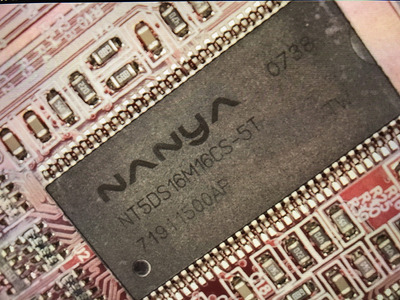

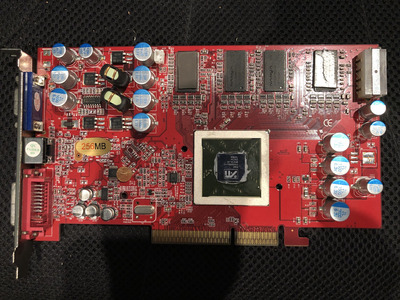

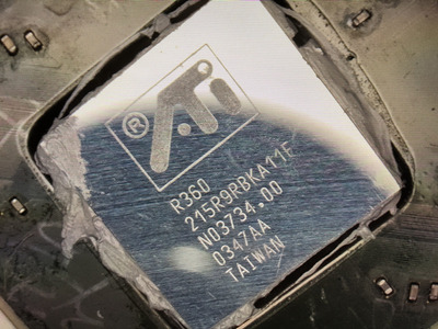

Here we go, The Grand Reveal..................What are your thoughts? Any way to tell if it's Pro or SE?
1.83 MiB
588 views
1.62 MiB
588 views
1.78 MiB
588 views
Reply 32 of 66, by Trashbytes
zuldan wrote on 2025-02-05, 07:18:
Here we go, The Grand Reveal […]
1.62 MiB
588 views
1.83 MiB
588 views
1.78 MiB
588 views
Good guessing everyone! What are your thoughts?
Ewww Nanya ram .. well that explains why its so damn slow, Im still with it being a flashed 9800 SE, it could be one of the rebadged cores or one of the defective R360 cores used on cheap OEM models. ATI did that a lot so not to throw away defective cores, just disable the broken part and use it on cheaper models.
Try flashing it with a 9800SE bios and see what it does.

Well seems like this card is kind of aftermarket frankenstein . 5ns memory wont get anything good as its 200mhz only plus 128 bit bus .ID recommend overclock memory as fast as possible as core doesnt give you any benefit because of memory... As at other hand its unique piese of hardware aswell as late chinese geforce 6800 with 512 mb of ram which was 128 bit too

I think that's an SE. I have the same style of card in my Athlon XP system. It is branded as a Radeon 9800SE and has the same style of memory (rectangular chips, 128 bits) and core. However mine has a Radeon 9700 type HSF and a floppy power connector. I believe it scored 4200 pts in 3DMark03.

Radeon 9800 se has memory 290mhz and 3.3 ns memory chips bga or tsop . This card have 5ns chips... It is still 9800 se but cuted even worse.
Here is 9800 SE by saphire
    751.58 KiB
    384 views

Reply 38 of 66, by momaka
Ooof!
It's a SCE....... Shitty Chinese Edition.
How I know? - The dreaded Sacon FZ electrolytic capacitors, as evident by the "FZ" marks written all over them. More info on these here:
Re: Brand NEW nVidia Geforce FX5500 256MB
Basically when you see those, it's gonna be a no-name manufacturer that built the card. Only exception are some XFX cards from the GeForce 6000, 7000, and 8000 series as well as many of the early EVGA GeForce cards (I think dating as far back as the FX series.) As far as I'm aware, ATI/AMD and their AIB partners never used these crappy caps. So if you get a Radeon card with those, that's a dead giveaway it's some Chinese Frankenclone of a card.
Also, as the others stated, those 5 ns memory chips are no good and your max RAM speed will likely be 200 MHz at best. If these are reject chips though, you may not even get that far... and I suspect this is why the memory frequency was turned down even lower than 200 MHz.
The core, on the other hand, should be able to OC well... but that likely won't be of any help indeed.
Now if you feel naughty and experimental, maybe try to turn down the GPU core voltage as low as possible for further reduction in heat/power consumption. With that, you could get a much longer-lasting card. Or alternatively, just use this card as-is and re-label it to remind yourself it's not an XT or PRO (or even regular non-pro) for sure.
