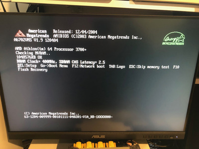

Every time I install a AGP card newer (EG 7600GT) than a 5950U in this board, the BIOS just hangs when powering on. The external power on the card is connected. Also tried a 7400 but no luck.
Any ideas?

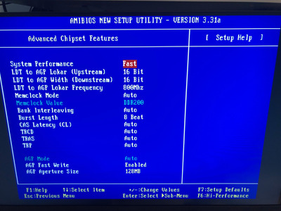

@Trashbytes, thanks for all your help. I found the problem. The old firmware actually works. The issue is if you set the System Performance from "Fast" to "Turbo", the motherboard no longer boots with the 7600GT. The users in that old forum thought the new firmware was fixing the issue but in reality, using the CMOS reset jumper, the System Performance was being set back to "Fast".
Changing the option to "Turbo" doesn't actually seem to change any settings on the BIOS, it must change something in the background. I haven't noticed any performance difference between Fast and Turbo.

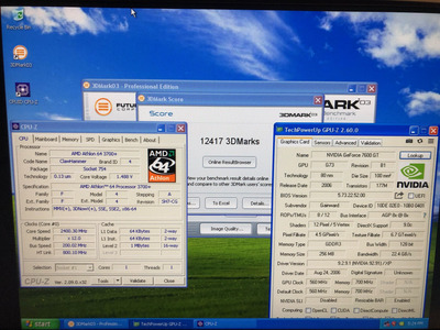

GO GO 7600GT!
