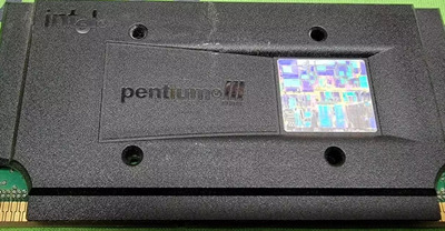

Reply 4 of 11, by Paadam
Had mseveral types of 440BX deskpros recently and most of them worked well with CuMines (to my surprise), that is Slot 1 versions which meant they already had correct VRM's etc.
If you have one that does not have VRM capable providing less than 1.8v then just use a slocket and any s370 PIII and set the voltage to 1.8v, it will work without issues.

Reply 6 of 11, by chinny22
Looks like you can go up to a 600MHz Katmai, it's a common limit for slot 1 boards.
https://theretroweb.com/motherboards/s/compaq … skpro-ep-3-dimm
Quick google of Prosignia 300 and AP200 which apparently used this motherboard doesn't bring up much re faster CPU's either.
Good news is my Slot 1 maxes out with the same CPU and I find it's enough for Win9x, Games that want something faster work in XP anyway.

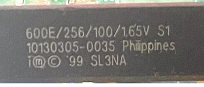

Reply 7 of 11, by dionb
Here's the service manual for that Deskpro:
https://www.manualslib.com/manual/30262/Compa … ?page=29#manual
It describes multiple system boards, the 118053-001 is the "PII/PIII System board, three-DIMM model (440BX) - (PCA=010233-101) Shipped on all PII and PIII units after 2/23/99)"
There are CPUs up to well in the Coppermine range described in the manual, but none are associated with this board, the fastest one with 010233-101 is P3-600 (Katmai).
But...
Take a look at this topic:
Compaq EP650 with a Pentium III 700 MHz?
It refers to a "Compaq 041Ch" motherboard. According to this that corresponds to 118053-001. So maybe it might work. But it's also possible multiple revisions/part numbers identify as 041Ch (3-DIMM BX board) and yours doesn't.
I'd just try - but no guarantees.
