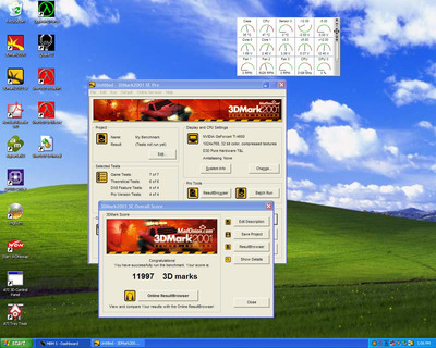

Reply 13 of 14, by Ozzuneoj
I feel like the 3dmark 2001se score is a bit low?
I remember pulling somewhere in the realm of 13,500 on my Athlon XP Thoroughbred overclocked to 2Ghz on an Nforce 2 Ultra 400 board alongside a Ti 4400 and then later a 9600 Pro (the Ti died). That was 22+ years ago, but the numbers are pretty clear in my mind. Pretty sure I was using 2x256MB DDR-333 in dual channel.
Even if the system scores 15-20% slower due to the chipset or something else, it seems odd that those games would run so poorly. Honestly, your CPU should be better since it has twice the cache vs mine.
... actually, you know what? I still have my old system running and I still have my 9600 Pro stashed away. I also have a my brother's Ti 4400 from back then I can test for comparison. It now has 2GB of DDR-400, but that shouldn't matter much. If I get a chance, I will run the 9600 Pro on it to provide another datapoint.
I feel like it is either an AGP issue or a software\driver problem. Just a shot in the dark... have you tried messing with AGP fastwrites or AGP aperture in the BIOS or any performance\quality settings in the ATi drivers? How about installing DirectX 8\9 manually?
EDIT: Now that I think about it, I clung to Windows 98SE for a very long time, so I may have still been using that at the time.
