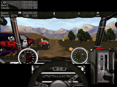

Updated with some improvements to the Glide-S3d wrapper. About 60-70% of Glide 2.4 games might now run to some extent, still probably only 10-20% are playable. Some extra CPU overhead now, performance might be down.
Ignition works better now, with some issues still. Might make sense to write a separate optimized wrapper for it, since it's one of the few Glide only Windows games.

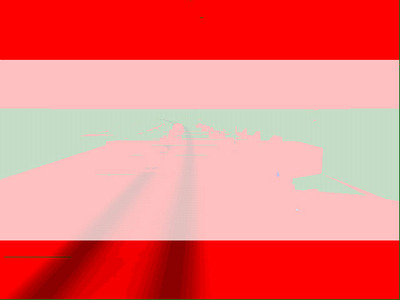

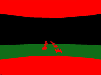

Some interesting glitches in various games. No idea what's going on in Monaco Racing Sim 2 for example.
    15.14 KiB
    1053 views
Reply 82 of 115, by myne
That looks like some kind of mask to separate where the sky, land, hud, and cars should be drawn.
Ie, one of the hidden processes rendering uses to sort the graphical data.

Reply 83 of 115, by vvbee
Could be, though in this case it may be something else. The game can also look like this and run at 0.1 FPS:
18.18 KiB
993 views
Not all Glide functions have been implemented in the wrapper, so it's not surprising that there are glitches. But it's interesting how some games can work almost perfect while many are completely broken. I think it's the unfortunate situation of Glide providing multiple ways to do more or less the same thing.

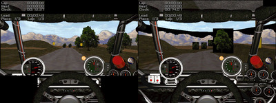

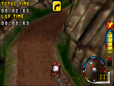

Updated with some updates to the Glide wrapper, and to add an optimized Glide wrapper for Ignition. There's now an INI file with options to tweak. For most games you'll want to disable perspective correction until you know the game runs, S3d seems to be more fragile in that mode. For paletted games reduce texture resolution by one step for 4 MB cards and two for 2 MB.
For Ignition there were some performance improvements, alpha channel stippling is now used to emulate an unsupported blending mode, and it'll auto detect VRAM size to scale texture resolution and support 2 MB cards. 4 MB cards will have half the texture resolution of the Voodoo, and if the Trio3D supports S3d well enough to run this then an 8 MB one would get Voodoo res. I want to test this wrapper on real hardware at some point, seeing some slowdowns in an emulator and it may happen on real hardware as well. I think the software mode looks the best out of all, but whatever.
Monster Truck Madness 2 (demo) now runs, previously it froze the system on frame #1. Somewhat slower than Direct3D and perspective correct texturing likes to freeze, but it also doesn't have the alpha glitches of the D3D version, which is interesting.

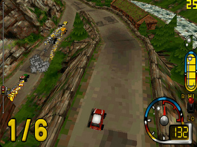

Monster Truck Madness 2 may be the next one that gets a custom optimized wrapper. The wrapped Glide version looks better than the Direct3D one, though maybe older drivers work better. Actually in the wrapped version the glitches are inside the cockpit while in the D3D version they're outside. Textures look a tad brighter in the Glide version, which is interesting. I remember hearing something about the 3dfx version having something different about the textures, but can't remember what.
150.35 KiB

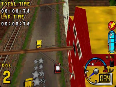

Updated with a separate wrapper for Monster Truck Madness 2. Fixes the HUD, adds fog, and whatever. Also runs on a 2 MB ViRGE, I don't think the game supports sub-4 MB cards by default so another bonus. Haven't tested it on real hardware but I'm sure it's about the same as emulated.

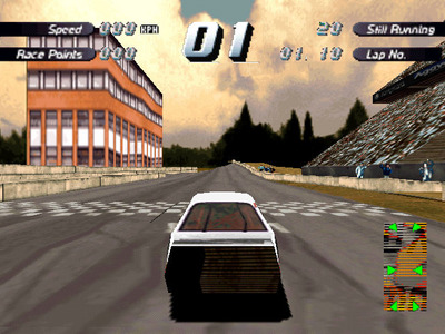

Updated with a Mystique-to-S3d wrapper for Destruction Derby 2. Alpha version.
76.73 KiB
272 views
At best works to some extent, typically is mostly messed up. The Mystique supports 4 bit paletted textures and the game makes heavy use of them + different palettes for different regions of texture atlases + the MSI API has no control over VRAM writes or texture uploads. Not good for the ViRGE, but it may be possible to support this game well at some point.
