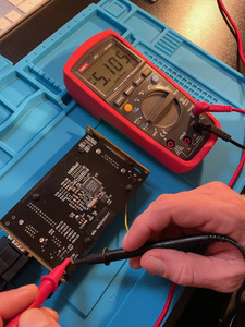

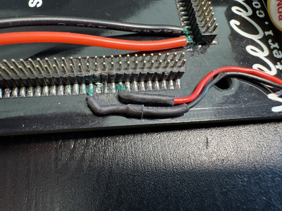

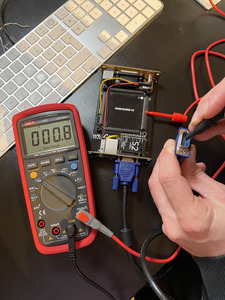

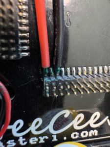

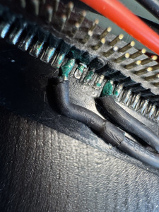

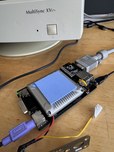

Reply 975 of 996, by aaronk
I have one of the WeeCees that @NachtRave assembled back in 2022 (SN NR0202011, to be precise). When it first arrived, it had an issue that I was able to fix with @NachtRave’s kind help—it turned out the SOM wasn’t mounted properly and needed to be pushed down a little. After that, I successfully booted into the Windows 98 setup. However, I put the project aside for a while as life got in the way.
Now that I’m back on it, I wanted to finish the Windows 98 installation using the included SD card. This worked fine at first, but after completing the installation and installing some drivers, the system stopped working. Upon reconnecting it, I saw the ScanDisk error check appear, but once that finished, it wouldn’t boot into Windows 98 anymore.
I then reflashed the SD card with the original image it came with. However, now it refuses to show anything on the attached screen—not even the POST screen. The blue LED on the SOM is lit up, as well as the LED on the Ethernet port. The keyboard LEDs also flash briefly when connecting power.
Besides the CRT shown in the attached image, I’ve also tried various VGA-to-HDMI adapters, but still no luck.
Do you have any suggestions for what I might try to identify the cause? Please bear with me, I don’t have a lot of experience with hardware troubleshooting. I’m also attaching a few pictures. Please note that I accidentally removed the yellow reset button wire, but I believe this shouldn’t be an issue (I plan to solder it back on once the WeeCee is working again).
Thanks in advance for any help!
    838.73 KiB
    469 views
    Blue LED is lit up, but the VGA monitor doesn’t receive a signal.
    1.77 MiB
    469 views
    1.04 MiB
    469 views
    812.9 KiB
    469 views
AMD Athlon 700 MHz / 64 MB RAM / 32 GB SD Card / ATI RADEON 7000 AGP / Terratec DMX Advanced Audio Accelerator / Windows 98 SE

Reply 978 of 996, by rasteri
aaronk wrote on 2025-03-08, 20:37:
Thanks, I’ll try this! But are you implying that it’s expected for the WeeCee not to output any signal if there is no (or a faulty) SD card installed?
oh, sorry no. It should display something. It's just that you said the problem appeared after the SD card was reflashed.
I suppose if the SD card was electrically faulty it could stop the system from turning on
Reply 979 of 996, by aaronk
rasteri wrote on 2025-03-09, 10:54:
Hmm, I guess something else is faulty then. I tried with other SD cards and also no SD card at all. In all cases, there’s no VGA signal, even though the blue LED on the SOM is on.
I will revisit the steps that NachtRave suggested when I had the initial issue in 2023, which includes checking the VGA wiring from the pin headers to the connector, verifying 5V power, and eventually removing the reset button. I’m attaching the photos from 2023, just in case they might be helpful for anybody facing similar issues.
If you can think of anything else for me to verify or rule out, please let me know. I appreciate your help!
