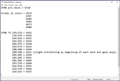

I dug back through some old files and found one such comparison on my Asus P3V4x motherboard, unfortunately there is not a lot of notes with it but I assume I was testing 9700 TX vs my pro and Fire GL X1-128. I do have a standard non pro now but might not have at the time of the test. Nothing scientific I would just do a game and nature tests and then write down what came out, I know there is always variances run to run and being a Via chipset probably some shenanigans there as well.
The attachment 9700.jpg is no longer available

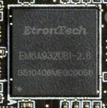

Is there a way to definitively identify a true Radeon 9700 Pro from a sale listing where you only have photos of the card but cannot see the core and memory clocks?
Yes, you should look at memory chips. Infineon chips are main indication of non-PRO card.
Pro came with 2.8ns chips, most of them Samsung. Some had Etrontech (FIC, Sapphire).
The attachment Etrontech.JPG is no longer available
