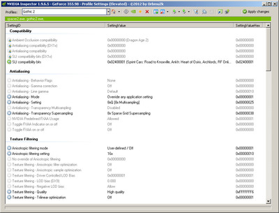

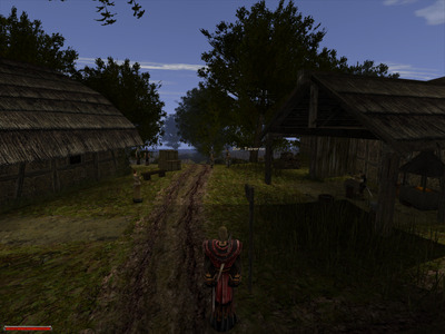

After watching a Digital Foundry video on SGSSAA and seeing it mentioned favorably on this forum, I decided to experiment with it a bit. So far, I really like the results. Also, I think being able to use this further justifies having an overpowered WinXP rig. For example, here's a screenshot from Gothic 2 (stock game, no mods) running at 1600x1200 with 8xSGSSAA on this system:
The attachment Gothic2_SGSSAA.jpg is no longer available
And the relevant settings from the Nvidia Profile Inspector:
The attachment NV_Inspector_Gothic2.jpg is no longer available
Besides cleaning up the jagged edges, SGSSAA also gets rid of the shimmering that occurs when you're moving toward objects with lots of fine details, such as tree leaves or tall grass. It can be quite transformative in some older games. From what I can tell, this is one of the best forms of anti aliasing, though possibly not for every single use case, as it can be pretty demanding. Anyway, just figured I'd share my thoughts on this.

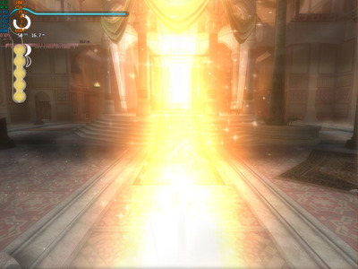

Small update: now that I've started using SGSSAA for further enhancing WinXP era games, I realized that I need to monitor GPU utilization a bit more thoroughly. This is mostly so that I can determine the optimal SGSSAA setting for each game, as their demands can vary quite a bit. For this, I use MSI Afterburner 4.6.4 which also comes with Rivatuner Statistics Server 7.3.3. With those, I can easily see how high my GPU and CPU utilization is for each game, which is especially important if I'm using SGSSAA. For example, here's a screenshot from Prince of Persia: Sands of Time running at 1600x1200 with 8xSGSSAA:
The attachment Sands_8xSGSSAA.jpg is no longer available
And here's the same screenshot with 4xSGSSAA:
The attachment Sands_4xSGSSAA.jpg is no longer available
You can clearly see how the frame rate starts to buckle when using 8xSGSSAA on my GTX 970 in this game. Granted, this is an edge case that I've deliberately created by standing very close to the sand portal which uses a lot of transparency effects. During normal gameplay, the frame rate stays locked at 60 FPS most of the time, but I still didn't like these occasional spikes. For that reason, I decided to drop to 4xSGSSAA for Sands of Time. It's kinda funny that a game from late 2003 manages to tax a GTX 970 so much, but that's the cost of using extremely high quality anti aliasing, I guess. That said, even 4xSGSSAA is pretty clean, with some very minor shimmering during movement, so it's still a great result.

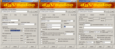

I've been testing this some more, and I think I've found the best dgVoodoo2 config for playing the original Splinter Cell on my system:
The attachment SC1_Settings.png is no longer available
Relevant settings:
  • Scaling Mode: Stretched, Keep Aspect Ratio
  • Video Card: GeForce 4 Ti4800
  • Resolution: 2x
  • MSAA: 4x
  • Smoothed depth sampling: turned off (for sharper shadows)

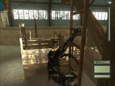

Running the game at 1600x1200 as its native resolution and using these settings gives me something comparable to 4xSGSSAA in terms of visuals:
The attachment Splinter_Cell_dgVoodoo2.jpg is no longer available
This looks super clean and doesn't tax my GTX 970 too much. The jaggies and movement related shimmering are almost entirely gone. Also, the first Splinter Cell is officially supported by ALchemy under Win7, so EAX 3.0 is working fine too.
EDIT - after some further testing, it seems that doubling he resolution causes some issues with thermal vision. Similarly, forcing MSAA causes the water rendering to glitch out on the Oil Refinery level. So while it's possible to achieve a very clean look using those features, there are some drawbacks.

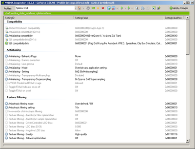

Small update on Splinter Cell. If you make the game use shadow projectors by setting ForceShadowMode=0 in SplinterCell.ini it will work fine even without dgVoodoo2. However, you will lose the high quality shadows and light sources. But on the plus side, in shadow projector mode, you can force 8xSGSSAA by using the anti aliasing compatibility flag 0x00000040.
The attachment NV_Inspector_Splinter_Cell.png is no longer available
The attachment Splinter_Cell_8xSGSSAA.jpg is no longer available
With this approach, there are also no graphical glitches on the water during the Oil Refinery level. Thermal vision works properly as well. Lastly, the game will run fine on WinXP, so you can get native EAX instead of ALchemy. Speaking of that, I recently learned that there is now a fan made fix which restores EAX 3.0 functionality to the GOG and Ubisoft Connect versions of the game.

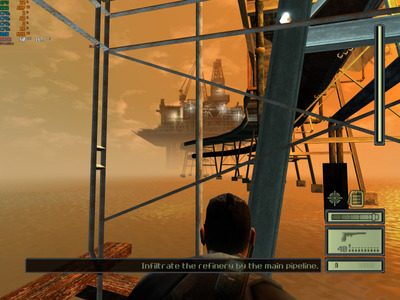

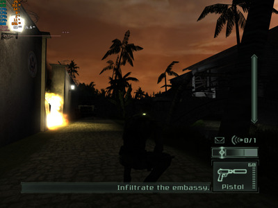

Since the original Splinter Cell worked with SGSSAA, I decided to test Pandora Tomorrow as well. And sure enough, it also works when using the same compatibility flag i.e. 0x00000040.
The attachment Pandora_Tomorrow_8xSGSSAA.jpg is no longer available
Those palm tree leaves never looked smoother, and they no longer produce any shimmering or flickering during movement. To address the missing light/shadow rendering on modern GPUs, I used this experimental fix. It's not 100% accurate, but it's still good enough to play through the entire game without any major issues. My usual test cases are the flashlights mounted on guard helmets and the huge floodlights in the mined courtyard near the TV station. Both of those render correctly with this fix. And best of all, it works under WinXP, so I can play the game there and get native EAX support as well.
I did run into an unrelated issue with the in-game movie playback. Updating the binkw32.dll file (as suggested by the PC Gaming Wiki) did help, but I'm not sure if the problem is completely gone.

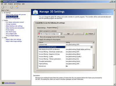

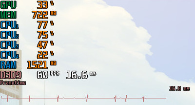

I noticed something odd while playing certain games like Mirror's Edge and Battlefield 2 under WinXP. While this rig is more than powerful enough to run those games at 1080p @ 60 FPS, my frame time graph (via MSI Afterburner) had some unusual spikes during normal gameplay. Here's an example from the first level of Mirror's Edge:
The attachment FT_Before.jpg is no longer available
I researched this a bit, and eventually realized that there's a setting which can smooth it out. It's called "Maximum pre-rendered frames" in older Nvidia drivers, such as 355.98 which I'm currently using. You want to set this to "1" then enable V-Sync in the Nvidia drivers, and lastly disable V-Sync in the game's video options.
The attachment MPR_Frames.jpg is no longer available

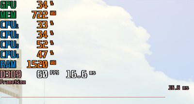

Here's the same area from Mirror's Edge after the aforementioned changes were made:
The attachment FT_After.jpg is no longer available
No frame time spikes anymore, and the game definitively feels more responsive to me. Now, depending on the type of game that you're plying, this might not be super noticeable. However, in a fast paced platforming title like Mirror's Edge, this can make a noticeable difference. From what I gather, this is a well known thing among hardcore gamers, but I wasn't aware of it until recently.
