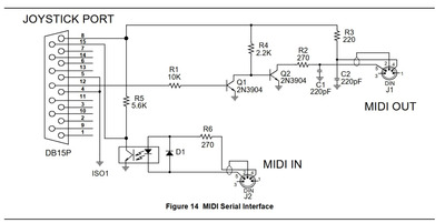

I have connected up a old Roland EM-10 synth to a 486 system with a game port to MIDI cable schematic I found in the datasheet for the sound card. It mostly works but I am having this strange behavior that when I play the DirectX MIDI external synth test and then I play another standard MIDI file (canyon.mid for example) it does not sound correct during some parts of play back. This can also happen when I play other MIDI files back to back as well. I am running Win 98SE with the default installed DirectX. I have to power cycle the synth to fix this issue. I will admit that I did not have a 270 ohm and a 220 ohm resistor to hand when I built the interface so I used a 500 ohm one on the positive rail to the MIDI jack. I don't think this will cause any issues but I could be wrong. I also used a 2.3K resistor for the pullup for the transistor in place of a 2.2K resistor but I really doubt that would be the issue here. I checked the rise and fall times on a scope and they are in the sub 250 nanosecond range so I think that is fast enough. I have also omitted the filter caps to ground as I don't have those values either. I have attached the relative section of the circuit from the datasheet.

You'll need to provide the MIDI files and recordings/videos of what it sounds like.
By the EM-10, you mean the Roland home keyboard, I presume? Basically a Sound Canvas.
I would presume MIDI is a binary state (either the data transmits or it doesn't), so if it's being transferred then that part is likely fine. My educated guess is that between files some states are not resetting, like pitch bend, but your explanation of "does not sound correct" is subjective and could mean many different things. Please provide more detail.

Reply 5 of 57, by SuperDeadite
Does Canyon.mid contain a GM or GS Reset message? A lot of MIDI files from that time period didn't. They just assume that your module is set to default instrument settings before playback. Manually reseting a module between different MIDI files is rather normal. If not done, then yes instrument mappings can get messed up.

Reply 6 of 57, by Falcosoft
Poot36 wrote on 2025-02-17, 17:24:
The playback issues I have had are missing instruments, too quiet instruments, corrupted and incorrect instruments. It seems to get worse the more MIDI files I play almost like it is not getting reset or something. I am using Windows Media player to play the files. I also have had the volume go to full even when I have turned it way down on the synth before playing a song (this happens without having played another song beforehand) I assume this may be normal as not all MIDI files do this.
Windows Media player does not send reset messages between Midi files on its playlist.
Try to play this Midi file between your tracks on the playlist. The file only contains a GS reset SysEx message.

Reply 8 of 57, by Poot36
Ok, I tired running the GS reset midi file and it did not appear to do anything? I tried to run it multiple times and no change. I also noticed that the DirectX midi test sounds almost like it is playing to slow at parts. I am running this on a 486 system with a Intel DX4 running in 2x mode at 66Mhz with 32Mb of ram and a 1Gb CF card and a CT1740 SoundBaster 16 sound card under Windows 98 SE with drivers installed for the sound card.
Reply 9 of 57, by Falcosoft

Then try this instead:

This also adds a GM reset before the GS reset and also sends a very brief NoteOn/Off sequence on channel 1 since it seems WMP has a tendency to ignore tracks if no channel messages are included at all.
You can check if the attached Midi does anything or not on your synth the following way:
1. Load and play a Midi track that changes the instruments on channels to be different from Piano 1.
2. Pause or stop the playback.
3. With the help of your Midi keyboard check that you really hear an instrument that is different from Piano 1.
4. Load and play the attached Midi file.
5. With the help of your keyboard check the active instruments.You should hear Piano 1 again on all channels.
If you do not hear any changes then the most likely problem is that you made a cable that does not transfer SysEx messages properly.
Since I do not know your synth/keyboard I cannot be 100% sure that it supports GM/GS reset messages but according to Spikey it is a Sound Canvas internally so it should.

Reply 11 of 57, by Poot36
Well the modified file works. Got any idea why Windows Media Player did not like the original file? Is there a better MIDI player that runs under Windows 98 that I should be using that would correctly play the GS reset file?
