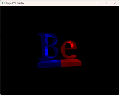

Reply 30 of 35, by lolo799
I couldn't get the emulatorto start with pm4400 as a model, is it supposed to be working already?
The 8500 worked in MacOS 8, atleast the install cd booted fine, trying to initialize a blank hfs hdd image failed.
And curiosity got the better of me, I didn't expect it to work so no surprise, it hanged there
21.62 KiB
3116 views

Surprisingly, pm4400 isn't among the models supported yet. The ROM is recognized, but no machines are attached to it. Not too big of a deal, but I'll keep this in mind for later. As for BeOS, that's another thing the SCSI refactor will hopefully address.
