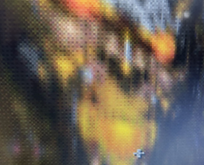

I have an S3 Virge GX 4MB card that I use mostly for non 3D. I’m aware this is a terrible 3D card, but was playing with some of its 3d capabilities for fun.
I have gotten it to work with Mechwarrior 2 Virge edition and GL Quake. But in either game, there is a very noticeable diamond pattern overlayed, like some type of dithering. Is this normal? Or is there a setting or something I am messing up? Software render actually looks far better. In 3D, textures are smoothed more, but this pattern is so distracting.

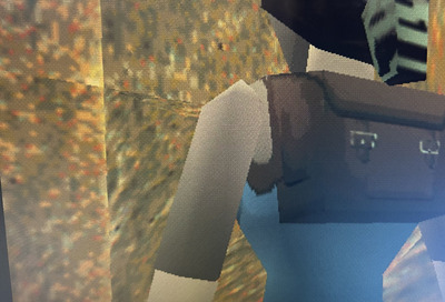

Reply 3 of 11, by Jhonny0099
Quake sample in 24 bit. Maybe this is just what this card does? Unless people are getting clean output from it?

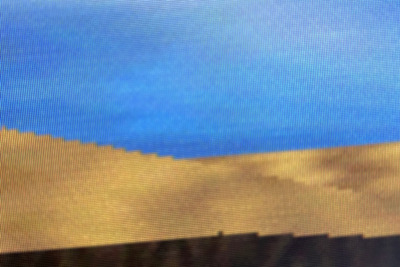

Reply 4 of 11, by Joseph_Joestar
I have seen the dithering pattern when running Tomb Raider in S3D mode on my Virge DX, but maybe not quite to the extent that you're experiencing. Here are some photos from that game that I took a few years back.
file.php?id=112145&mode=view
file.php?id=112144&mode=view
Also, it's possible that my phone's crappy camera smooths out the dithering effect. I can't double check this at the moment, as my Virge DX is currently sitting in storage.

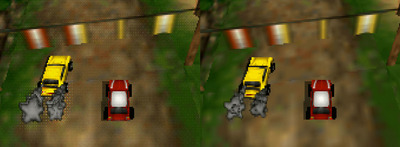

Reply 6 of 11, by vvbee
It's possible few S3d games are willing to use 24 bit color unless you modify them. S3d itself supports 24 bit modes but they weren't often used. Try something in Direct3D and be sure it's running in 24 bit without guesswork. It'll get rid of not only the overall dithering but also the alpha bug where fully transparent sections are dithered.
Reply 7 of 11, by leileilol
The dithering is normal behavior. It would be ugly and banded if it weren't. ViRGE isn't the only old 3d card to do this.
It's also normal for S3 to erroneously apply the dither in translucent texels. (i was hoping this thread is about that)

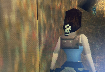

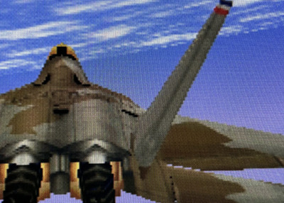

Reply 8 of 11, by Jhonny0099
I was able to try a DirectX 6 .1 game, F22 Lightning 3. I can confirm the pattern is there, but looks better. At 1024x768 it’s pretty minimal unless looking closely. At 640x480 the pattern is much larger and noticeable. This game runs pretty slow in any resolution. This game says it only supports 16-bit color .
1.69 MiB
230 views
I can confirm Tomb Raider looks similar to the Tomb Raider sample shared above with S3 Virge Patch. It doesn’t tell you what resolution it is or let you choose it, but monitor says 640x480. Pattern is still there, but much tighter and harder to see.
Maybe this is just how the card is. Lower resolutions make it really bad, higher resolutions hide it better but still always has a speckled look.
