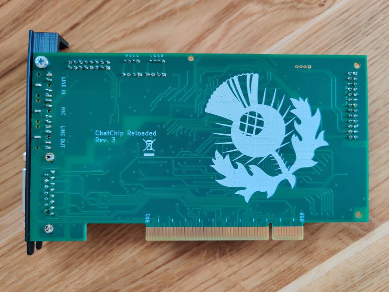

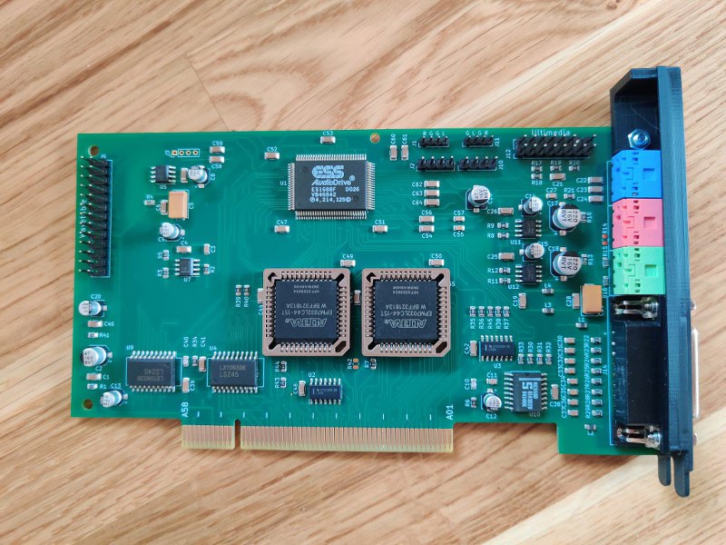

I have created replicas of the famous ChipChat sound card, which is compatible to the Sound Blaster (Pro) standard, offers a wavetable header and works reliably even on the fastest Micro Channel machines.
If you're interested, please sign up here and I'm happy to help:
https://www.cognitoforms.com/Vintech2/ChatChi … ssionOfInterest
Reply 25 of 34, by dr.zeissler
Does your card have a compatibility matrix? does it fully work with a Model 56 486-slc2 ?
Reply 26 of 34, by Nostalgienerd
The card is known to be the most compatible for any from the slowest to fastest systems.
I never received any feedback from other users that it did not work.
