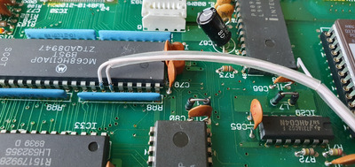

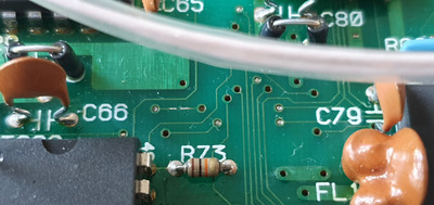

Reply 80 of 90, by Nifty
I'm not a big fan of the idea of soldering to a trace on a PCB, so I decided to solder wires to the processor pins. The trace was cut using a Dremel and a thin drill, so there is less chance of damaging adjacent PCB traces and it looks neat.

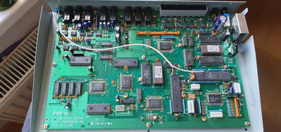

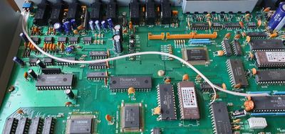

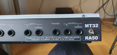

Hi everyone
I made the mod on my RA-50, but I am facing a strange behavior:
In RA-50 mode, everything works fine
But when switching to MT32 mode, I got the "LA Module sound module is not present!" message and... absolutely no sound coming out!
I checked the wiring, the soldering, everything! And I cannot figure out what is wrong
Any clue ?
Reply 90 of 90, by Salient
EdOX wrote on 2025-04-03, 18:02:
Hi everyone […]
Hi everyone
Any clue ?
Does it at least give any sound if you undo the MOD?
And have you done this:
- Push and hold "WRITE" and power on. This will put the device in factory default (E-20 mode).
- Push: "MIDI", "7", "+", "MUSIC STYLE". Now the display should show MT-32
This puts the unit in actual MT-32 mode.
