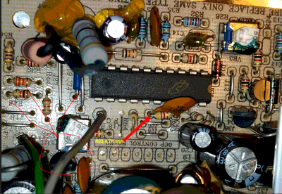

Hmm, that's weird. On mine there's no resistor under the yellow cap. Maybe different revisions? (mines rev 2)
I have finished putting the PSU back together, albeit without the secondary transistors, and the bulb flashes once on power up (normal). Not continuously on.
What's weird is that the 5VSB is nonwhere to be seen.... From my understanding the 5VSB here is generated directly from the primary side, and is isolated from main rail generation (ie. 3.3v/5v etc...).
Actually scratch that, I'm still missing an TO 92 transistor which blew up near the PWM ic. Can't find the markings on what it is tho...
DAVE86, could you do me a favour once again and tell me the model of the one I marked in the attached photo?
    388.98 KiB
    546 views

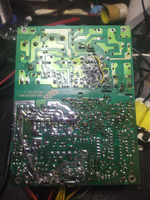

Reply 30 of 73, by momaka
kotel wrote on 2025-02-24, 04:40:
May I know where's the sec aux rail? I cannot find it.
please don't smoke me for the trace repair
Hehe, no worries, that trace repair looks quite alright. 😀
I might have a grudge with the quality of the pictures, though. 🤣
Trying my best to work it out right now, but only really the bottom (solder-side picture is clear enough to trace anything.
That said, if you look on the 5VSB transformer, you will see 3 pins on the secondary side.
Normally, one is ground, one is the output for the 5VSB (goes to the Anode of the 5VSB diode), and one is the output of the sec. aux. rail (goes to the anode of a smaller diode.)
But occasionally, the 5VSB rectifying diode might be installed on the grounding pin of the 5VSB transformer, with the anode connected to ground and cathode connected to the grounding pin... and then the 5VSB output pin goes directly to the 5VSB. The sec. aux. rail will still have its own diode and connected the same way as before (i.e. anode to sec. aux. output pin and cathode to the actual sec. aux. rail.)
Since I don't know which configuration you might have here (and since your 5VSB is pretty dead anyways), go ahead and remove the 5VSB transformer out of the PSU. After this, use your multimeter to see which pin on the board connects to ground (if any) and which pin connects to the 5VSB anode (if any) or cathode (if any.)
From what I can trace from this picture of yours and looking at the pins of the 5VSB transformer, it looks like you might have case #2 above, where the 5VSB diode is on the grounding pin. In any case, this grounding pin is the right-most pin. I can't tell what the other two are, so either you will need to do a little hunting / figuring out for me or try to provide another photo of the top-side of the board that's more clear and with better lighting (consider using flash on your camera, if you don't have much light in the room.) Anyways, if you do find the diode for the sec. aux rail (again, it will have its anode connected to one of the other two pins of the 5VSB transformer), you can insert / backfeed the 12V from your external PSU at the cathode of that diode.
kotel wrote on 2025-02-24, 18:01:
I habe double retraced the connections from 5vsb transformator and none of them seem to be tied to the two small TO-92 transistors near PWM IC, therefore I have no clue where to inject that voltage. They are also the closest to the 5vsb transformator too.
Yes, the driving transistors won't be directly tied to the sec. aux. rail. Instead, their Bases are pulled up via high(is)-value resistors, typically in the range of 1 to 2.7 kOhms.

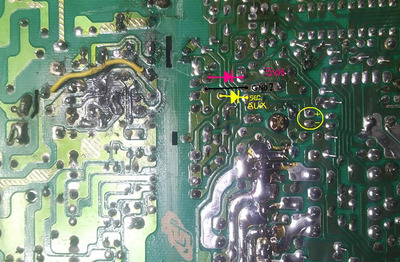

Reply 31 of 73, by kotel
momaka wrote on 2025-02-26, 00:09:
Hehe, no worries, that trace repair looks quite alright. :) I might have a grudge with the quality of the pictures, though. LOL […]
Yeah, the picture quality is nothing past amazing :\ Probably due to too much light and the fact I need to use outlook compression system for them to fit max size of 5mb. Zipping them also doesn't help. I could upload them to google drive and then post the link here, although I don't know if that's convenient for you.
I'll try my best to redo the pictures and trace where the other two pins of the mosfet go. Sadly my local hardware store doesn't have any MOSFET's or transistors, so the only way I can get them is either ali or TME.

Reply 32 of 73, by momaka
kotel wrote on 2025-02-26, 08:41:
It's not a matter of picture size or resolution, but more of a poor focus and not great light.
When I annotated your picture in the Tagan PSU thread on BCN, note how much of the image I cropped away.
I almost never use the largest image format of my camera (be it my phone or my digital cam) at the time of taking the picture. That way, I'm not taking huge images and then having to deal with huge image and file sizes that don't really add anything to the quality. For most of my PSU pics, I use 2 MP resolution (1600x1200). Only for the bottom / solder-side shots I might bump that up to 3M or 5M, if there are many tiny SMD components. And once I'm done taking the photos, I always post-process them with software (I use an old version of Photoshop - 7.0... but Paint.NET is a pretty good free replacement) to crop away any unnecessary areas and reduce the image size.
Also, if anything, I think your pictures could use more light. 😀 It's best to take shots near a window where you have natural light (usually during the day). If you don't have that, perhaps you can take the pictures outside. And if that's not an option either, then use the flash function of your camera as a last resort. Just beware that flash does have some side effects on the photos. For example, if you take the photos straight-down, a lot of times the PCB and some shinier components will flash back at the lens, making things hard to see. At the same time, if you angle the camera too much, the components will cast long shadows from the flash, and that also will make it hard to see things on the board. So the optimum is usually almost-straight-down shots, but angled ever so slightly to minimize flash back. Now, for solder-side shots, that's one place where I *always* turn off camera flash. Regardless if you're using a phone or a stand-alone digital camera, the flash is a point-source of light, so it's very hard to take a nice shot with even light everywhere. So for solder-side shots, I always take my device near a window and take the shots there. The difference is night and day in the clarity.

Reply 35 of 73, by momaka
kotel wrote on 2025-02-28, 17:35:
I have tried injecting 10v into the cathode of that diode and it was pulling max set amperage (690mA, then 1A, then 2A) with its voltage down to 28mV on 2A. I suspect its because the PSU generates a higher voltage on that line, although before I try injecting 14v I would like to consult the profesionals if this behavior is normal.
Nope, that's not normal.
That said, did you check if the orientation of that diode I annotated in yellow (for the sec. aux. rail) on the picture actually matches the one on your board? Just want to make sure I didn't make a mistake somewhere with that. Also, I'm sure you know this, but also just checking things on your side (one can never check things too many times 😉 ) - the cathode side of the diode is the one with the band marked on the diode. If all of this checks out, then either that diode for the sec. aux. rail is faulty or your TO-92 driver transistors (Q4 and Q5, I think) are bad, or their protection diodes (D11 and D26??) are bad. Remove and test each and report what you find in detail (mV readings, and etc.)
Also, since your 5VSB had quite the blowout, the 5VSB transformer might be damaged / bad. Normally injecting 5V at 5VSB and 10-15V at the sec. aux. rail should *not* affect anything even if the 5VSB transformer is bad, since the 5VSB and sec. aux. rectifying diodes shouldn't allow reverse current... but just in case, remove the 5VSB transformer and see if the high current goes away.
In fact, here's how to proceed:
1) remove 5VSB transformer and inject 5V into 5VSB and 10-15V into sec. aux. rail. Is the current draw on sec. aux. rail still high (over 500 mA)? If yes, proceed to 2) below.
2) remove the two 1-KOhm resistors that are next to driver transistor Q5. Inject 5V and 10-15V into 5VSB and sec. aux. rail again. Is the current still high? If yes, proceed to 3) below.
3) Remove driver transistors Q4 and Q5. Inject the voltages again. Is the current still high? If yes, proceed to 4) below.
4) Remove the protection diodes (D11 and D26) that are close to the spots for transistors Q4 and Q5. Inject voltage again. Is the current still high? If yes, proceed to 5) below.
5) Remove the sec. aux. rail rectifying diode (one annotated with yellow in my diagram, not sure what designator this is on the board). Inject the voltages again. Current still high? If yes, go to 6) below.
6) There's really not other components that can cause a high current draw, so if you've reached this step, double-check all your work again, because you've probably made an error somewhere.
Report back to what step you got and any additional information.
