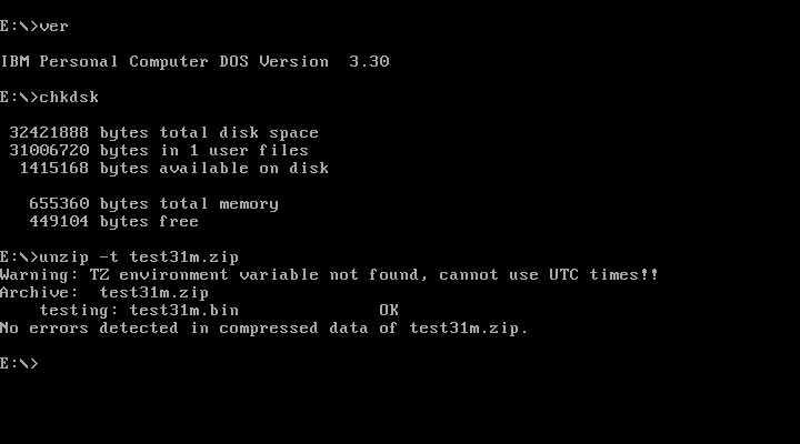

Default is 4 sectors per cluster - works fine:
3.56 KiB
768 views

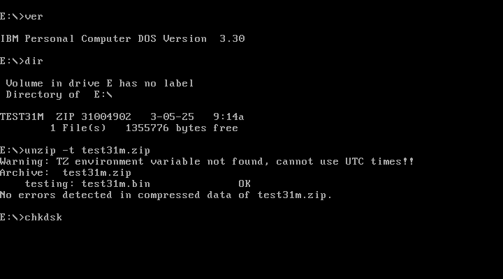

Now, let's reformat it to 2 sectors per cluster:
$ mkfs.fat -v -s 2 test31m.dsk
mkfs.fat 3.0.20 (12 Jun 2013)
test31m.dsk has 64 heads and 32 sectors per track,
logical sector size is 512,
using 0xf8 media descriptor, with 63488 sectors;
filesystem has 2 16-bit FATs and 2 sectors per cluster.
FAT size is 124 sectors, and provides 31603 clusters.
There is 1 reserved sector.
Root directory contains 512 slots and uses 32 sectors.
Volume ID is 5b8a7888, no volume label.
Still kinda works, but CHKDSK hangs:
3.48 KiB
768 views

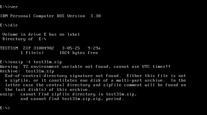

...which results in DATA CORRUPTION!!!:
4.99 KiB
768 views
Conclusion:
- 16-bit cluster numbers don't work with DOS 3.30
- 15-bit cluster numbers work with DOS 3.30 kernel, but not CHKDSK
- 14-bit cluster numbers fully work with DOS 3.30
- it seems that FORMAT command in DOS 3.30 never exceeds the 14-bit limit
- "netdrive create hd FAT16" needs improved for compatibility with DOS 3.30

mbbrutman wrote on 2025-03-06, 04:35:
What exactly was the behavioral difference?
"netdrive create hd 31 FAT16 test31m.dsk" - even DIR results in garbage - download/file.php?id=213580&mode=view
"dd if=/dev/zero of=test31m.dsk bs=1048576 count=31 ; mkfs.fat -s 1 test31m.dsk" - DIR does work - download/file.php?id=213708&mode=view
