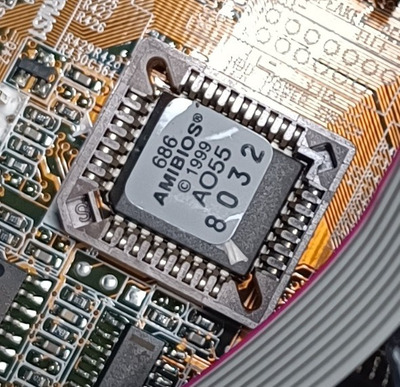

I unfortunately didn't backup the original BIOS.
Took a picture of the BIOS chip, if anyone has any clue of what I need to reprogram it manually.
I occaciounally have BIOS access, yes. But the BIOS doesn't recognize any drives at all.

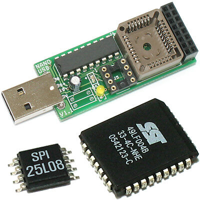

I personally own one of these: https://www.amazon.com/TL866-3G-Programmer-Su … 0CCDCP7LK/?th=1
Comes in very handy. I use it to read/backup and flash ROMs when needed. The set I got ($85) one, comes with adapters for most all the common chips, including yours (PLCC32). For a "cheap" programmer, it works really well. I've got a lot of use out of mine. Of course, I use the term "cheap" loosely. At $85 it's cheaper than most, but it's hard to justify if you don't need it all that often.

Reply 6 of 20, by dionb
Second both the TL866 as best solution and hot-flashing as plan B if you don't have one and don't want to get one.
Your issues are due to the rev 1.0 having 686A southbridge and the 2.0 having 686B southbridge. They need different BIOS code so with the wrong one you lose southbridge functionality, including floppy and IDE.

Thanks for the response. I was looking into these adapters, but man, for a one time use, I don't find it worth the price. I'd rather buy something like the picture I've attached instead. But dunno how well those work and they seem quite hard to find in my area (Sweden).

Thanks for the reply. Im not really keen on buying something at that price if im only gonna have one use for it tho 🙁
Is there no place to buy PLCc32 chips that are pre-installed with the BIOS of your need?

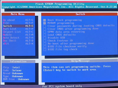

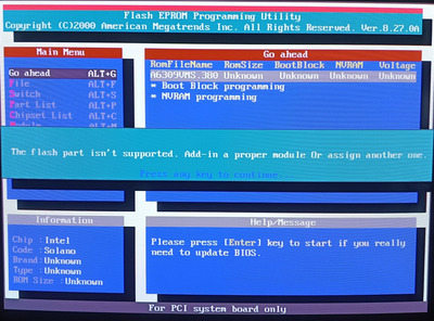

Thanks for the hotswap tip. I tried this out with another motherboard i had. Just as you described. However I got this error message that I attached a picture of.
Seems like im unable to write the bios to the swapped PLCc32 chip. Dunno if it has anything to do with the one PLCc32 chip being AMI and the other being AWARD.

At a guess - the broken one is a 2Mbit and the hotflash board is probably 8Mbit - try and find an older board
There are different types and capacity plcc32 eeproms - they're not all cross compatible. Pull the sticky label off the bad flash chip and post a photo of the chip and we can work out what size/type it is
Reply 11 of 20, by dionb
Ribbicipp wrote on 2025-03-08, 20:56:
You can find it for quite a bit cheaper than that on AliExpress. Watch out that some prices can be misleading, with different 'colours' being just a single adapter instead of the main kit.
That said, if you're into vintage computing, you'll be having a lot more opportunities to use a device like this. It can flash BIOS, it can back up old BIOS, it can check whether BIOS EEPROMs are still working correctly, it can test SRAM chips, it can test 74-logic chips etc etc.
First you need to know what chip you need, PLCC32 is just the shape, not the type of chip. But even then: not likely. Not many people need to flash ancient EEPROMs and most of those have the necessary hardware themselves. What's left is hardly something to build a profitable business model around.

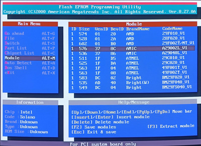

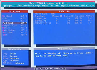

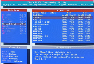

Assuming you were using the standard AMI flash utility, you may still be able to do it with the Uniflash utility (no guarantees of course). And I've found that putting a strand of dental floss under the lightly inserted chip makes for easy extraction when doing a hot swap.
Is the correct BIOS for the board an Award or AMI?
Is the Uniflash utility able to run in dos?
The correct BIOS for the board is an AMI (as seen in the picture on my previous post in this thread).
The depicted 25 and 49 series chips are serial eeproms, completely different from the parallel 29 series one I'd guess your mobo's BIOS is stored on. It would really surprise me if those dirt cheap programmers could handle parallel eeproms.
There are some homebrew Arduino based parallel eeprom programmers , like Tommyprom, Ben Eater's programmer, etc, that might support your chip without modification if it's written in 128 byte blocks, but the suggested XGecu T48 ("TL866-3G") is probably the cheapest and easiest to use programmer that's guaranteed to with those out of the box.
As mentioned, if you get hooked on this hobby or are generally inclined to tinkering with computers/electronics stuff, you'll find plenty of use for it over time. In my opinion, a universal programmer with an extensive set of adapters for different packages is almost a must in any retro enthusiast's toolbox.

Regarding the hotswap:
I've been messing around with three different flash eprom programs and tried out different settings, doing the flash in different ways etc.
The first program i tried was implemented in the latest (v3.8 ) BIOS zip that i downloaded from here: https://theretroweb.com/motherboards/s/msi-ms-6309-v2-0#bios
It's called AMIFL827. Guess that's short for AMI flash?
That program has so far been working fine, except for a few problems that I have no idea of what to do with as im not very experienced in this matter.
I've attached a few pictures in this post to show you what the program shows me when launching it from DOS.
I launch it by typing "AMIFL827 A6309VMS.380" (A6309VMS.380 being the bios flash file. I was expeting an ISO or BIN file, but I was unable to find any at all).
When I launch into the program I get this:
607.66 KiB
153 views
Im guessing it says the flash part isn't supported due to the hotswapped bios chip? Or simply because the correct settings haven't been entered?
When I dig into the other menus i get presented with different settings, like how the flash should execute. Dunno really what's important to check from the list here:
631.22 KiB
153 views
Then further down the menus you get a "Part List" with three different options. Im guessing this is for what type of BIOS chip it is and what kb size it has:
553.14 KiB
153 views
Even further down the menu you get "Chipset List" and "Module" with many different options (more than shown in the pictures) of what DevID, brand, etc you can choose from.
I have no idea of what to check in these menus. When trying the "Auto Detect" option it only chooses Intel and Solano and two Unknowns (as seen in the bottom left corner):
617.69 KiB
153 views
514.04 KiB
153 views
As an experiment I tried flashing the chip with just random settings and as long as I chose that it's a 256kb chip, the rest of the settings didn't really matter since the flash was successful (a bar ticking up, showing that it was flashing to the chip). However, when trying out the BIOS chip in the other motherboard, it didn't work at all. Guessing you need the right options for it to work...
I have also tried the Uniflash utility, but several options seem to be greyed out, making me unable to do anything useful.
