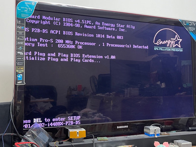

I underestimated the difficulty of using the Pentium Pro Slocket card. Can the bios provided by this website https://oezmen.eu/bios/ support the PPro adapter card?
I downloaded the bios of P2B-DS from this website yesterday and got stuck on this screen. I don’t know why?
However, I can enter Windows normally using a non-PPro CPU, so I don’t quite understand the problem.

This old CPUs should AFAIK POST without microcode update, problem is somewhere else in BIOS code.
Gigabyte GA-P67-DS3-B3, Core i7-2600K @4,5GHz, 8GB DDR3, 128GB SSD, GTX970(GF7900GT), SB Audigy + YMF724F + DreamBlaster combo + LPC2ISA
Reply 329 of 351, by maxtherabbit
This is NOT micro code issue. It's the crash which occurs when the BIOS attempts to write to special registers (MSRs) which exist on p2/3 but not on ppro

millobo2016 wrote on 2025-03-07, 16:51:
Disadvantages
1. Slightly poor compatibility, P3B-F Mod bios can operate, P2L97 1.02 bios lacks microcode and cannot install XP, Tekram P6F40K-A5 cannot boot
Not being able to install XP with LX chipset and for example Coppermine CPU (and apparently Pentium Pro also?) is known compatibility issue with these chisepts. It is not caused by the slocket.

I got a P2B-F motherboard today, but unfortunately I am still stuck on the pnp check again when using the pentium pro CPU. In fact, I personally agree with paying for bios , because modifying the bios requires a lot of time and technology, and I don’t think it should be free.
