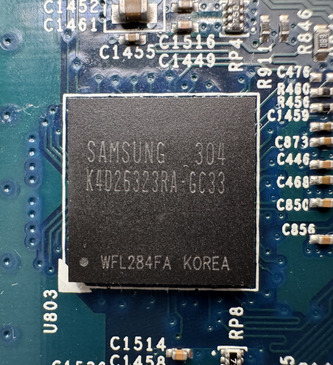

Reply 2 of 13, by ChrisK
What is your old RAM? Can you post a pic?

Reply 4 of 13, by byte_76
ChrisK wrote on 2025-01-29, 08:26:
Here's the pic.
Do I need to change anything on the board of the GF4 Ti 4200 if I change to a different brand of memory such as the one listed a couple of post above? (I've seen YouTubers change straps for new RTX cards when they change the brand of memory on the board)
Reply 6 of 13, by ChrisK
byte_76 wrote on 2025-01-29, 10:44:
Here's the pic.
On Radeon cards (I know of 9xxx and first X-series) there are straps for different RAM manufacturers. Don't know what they do, maybe change some fundamental RAM timings or the like and also don't know if that is something to care about on nvidia cards.
My reason for asking for the photo was determining the RAM type used on your card. My Ti4200s use TSSOP DDR. The fastest you can get there is commonly 4ns. Some manufacturers also made 3.6ns but those are very hard to get and also need higher Vcc. So swapping, if making sense at all speed-wise, would also have meant changing/increasing voltage.
But yours is BGA. They do go quite a bit faster than TSSOP. But they are also more difficult to change. If there's an error with soldering at one chip you will hardly know which one needs rework.
Regarding the voltage you're in luck. Your old 3.3ns RAMs should already use 2.8V (same as the 2.2ns mentioned above) whereas the 3.3ns variant of hy5du283222af would have used just 2.5V.
So in theory a swap should be possible.

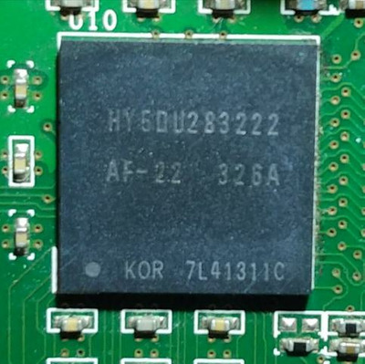

Reply 9 of 13, by byte_76
I received the replacement modules and went ahead with the swap.
The card now displays the initial description at power on without any artifacts but the memory size indicates 64MB instead of 128MB and the screen just goes black after that without turning off the monitor. Like the card doesn’t initialize properly at POST.
Is it likely that there was an issue with the soldering or could this be an issue with the video bios or maybe some sort of straps?
The card had 8x Samsung modules before (4x front, 4x rear) and now it has 8x HY5DU283222 AF-22.
It is challenging to replace all 8 modules because, to do the modules on the front, I can mount the card onto the pre-heater and easily solder the new modules, but for the rear modules, facing the card downwards with the caps facing the pre-heater would be problematic, so I use only my hot air station and this requires more time and more heat to melt the solder.
How do you usually tackle the challenge of desoldering and soldering the rear modules?
Reply 10 of 13, by stef80
Not sure if this is worth the effort. Maybe if you go one-by-one chip, and test every time. Balls may be connected underneath. Maybe you can locate problematic chip if it is overheating. It may also be something else. Memory controller on 9700 is quad-channel, so you have 2 channels not working? You'll need fresh set of chips or reball existing ones if you desolder.
Reply 11 of 13, by byte_76
stef80 wrote on 2025-03-11, 12:13:
The card that I’m working on is a Geforce 4 Ti 4200. It has 4 chips on the front and 4 on the rear, which should add up to 128MB
At this point I’m not sure what the issue might be so I’m considering removing all chips on one side of the board and reballing. After that I’ll test again and then repeat on the other side if the problem remains.
If that still doesn’t resolve the issue, I’ll cut my losses and use it as a parts card.
Reply 13 of 13, by dm-
front side of the card is the first 64mb of ram (64bit wide)
back side of the card is another 64mb of ram (adding 128bit support)
if any memory module on the back side was soldered not properly, card will go to 64bit / 64mb
it is ok to reflow the chips by heating and "moving" the chips to make sure all balls are soldered properly. just add a little flux
