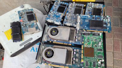

Recently, i got this nice set of 8 cards for MAC, which is included:
- 2 Geforce Ultra 5200 64Mb 128 bit.
- 3 Radeon 9600 Pro/XT 64/128/256mb each.
- Some green Radeon... unfortunately dead/ no detect.
- and a bonus. 2 pcs Geforce 6800 Ultra DDL MAC edition.

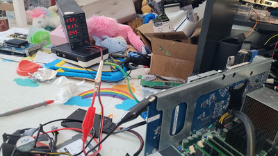

So this Geforce using ADC 25V power rail to supply a voltage to NVDD. ADC 25v --> 1st buck converter down to 12V --> A very big COIL 😀 --> NVDD 3 phase buck converter
First i attached 25v from my lab source to ADC pins and started the PC.

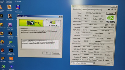

Yes it's has been detected by nvflash.
I flashed with 6800Ultra bios and run into Windows. And it's been detected correctly, installed the drivers and...
139.9 KiB
177 views
So i flashed to 6800GT
The warning is gone, and card works as expected.

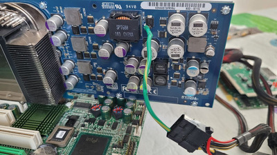

Now, i do not want to run the card with 25V attached. What if i can attach 12V directly to output of 1st buck converter.
210.51 KiB
177 views
And it's working!
So, all we need is to attach some power connector to the point before the BIG COIL. Let's do this:
87.62 KiB
177 views

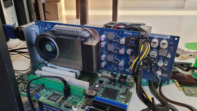

Now i have fully working Geforce 6800U DDL MAC Edition running on PC.
(here should be a picture of running 6800 but i ran out of limit of attachments)
Now. Downsides:
- DVI does not work. both. Probably it may be fixed by doing some modding work with nvidia bios.
- DSUB output is working but it's a little bit blurry. Higher resolution - more blurry. And i understand this, most likely APPLE does not have a DSUB monitors for this at all -)
- Weird PCIE external connector must be attached to the card.
