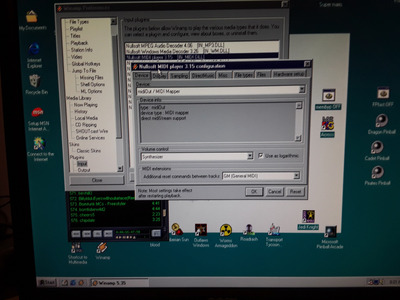

@Falcosoft Well it looks like the MT32 mode does not work at all as it just results in no sound at all. Oh well. There is a file Deadend.mid that I have that does not play correctly (random loud instruments are played around half way through the file) and it ID's as a GS compatible file.
I think the SC-88 fileTxplasma.mid also sounds weird as my synth is a strange combination of units in a sense. When I tried you instructions for setting it to SC-88 mode it sounded even more incorrect.
I have attached the files for you to take a look at.
Would it be worth it for me to attempt to dump the wave rom and system rom? I may not be able to dump the system rom as it is 16 bits wide and I am hoping to use my USB 2.0 8 channel 48Mhz LA to view the data when I run the built in rom tests. I don't think my programmer from the 80's can handle this chip layout and I don't want to risk un-soldering the chip so my plan was to clip the LA onto the data bus legs.
Also found the jumper for the CPU multiplier so I changed the FSB to 33Mhz and the multiplier to 3x as the system was not stable when running the video at 800 x 600 at 50Mhz FSB.

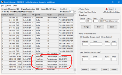

The only other controller that I could find and can be relevant (i.e. it is modified at the moment the problematic sound starts) is the Modulation Wheel (CC#1). Here is a version the removes modwheel 120 events from both channel 4 and channel 8.
The attachment DEADEND_NoModWheel.zip is no longer available

Hi,
If the NoModWheel version plays fine then I have a plausible explanation:
Your synth does not support properly one or more of the SysEx messages that modify the modulation wheel LFO behavior on channel 4. The used SysEx messages also can be seen on the screenshot that I posted previously related to the Tempo Change events.
Your synth somehow misinterprets these SysEx messages but the problem only manifests itself when the modulation wheel (CC#1) is set to a higher value (120) on channel 4.
So without changing the default modulation wheel parameters your synth can interpret modulation wheel messages without problems but if some GS specific SysEx messages modify some LFO parameters then problems can occur.

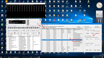

You can try to fix the problematic SysEx messages with the help of my Midi Player:
Load your original DEADEND.mid file with Midi Player
1. Open the Event Viewer/Debugger.
2. At the very beginning of the event list you can see some SysEx messages.
3. Remove/delete the channel 4 mod wheel LFO related ones:
F0411042124024055542F7
F0411042124024063066F7
4. Save the file and re-load it with Midi Player.
The attachment NoLFOSysEx.png is no longer available
