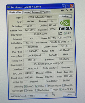

Not sure what else to do 😢, if you open you gpu-z can you see the box of physxs checked? Because mine dosent.
Yup, the PhysX box is checked.
file.php?id=173387&mode=view
This screenshot is from when I was using the 344.11 driver, but it's the same with 355.98.

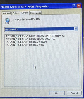

Thank you all for your help, unfortunately my issue continues there, I removed the driver completely from the system to assure a clean install, I did what myne told me still not working, I replaced the files you send me but still Physx not working, well I guess I will have to live without it but I did find something curious, the id of the GPU that I manage to look thru the driver details I found that it have a REV_A1 at the end of the identifier, not sure what that means but I dont think that could be device id, like it has two differents.
Anyway I just give up with this, thank you all for your help again.
