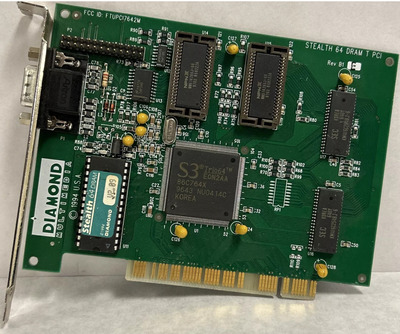

S3 PCI video cards were very popular among computer manufactures because of their good performance and support.
They work with
OS2
Win3x
Win95
Win98
WinME
Win2000
UNIX
Linux
Sun Solaris x86
Etc…
For DOS gaming they work pretty good.
S3 trio64 VX / DX 3D
2mb is good enough.
    531.15 KiB
    415 views

You asked for the best 3D performance. There's not really any distinction between 3D and 2D peformance if the card is not a 3D accelerator, like a Voodoo. With software rendering, both 2D and 3D are a matter of how many pixels you can push to the screen per frame, at least as far as the graphics card is concerned.
That is to say, with software rendering, you have two concerns: the *general* performance of your graphics card, and your CPU.
In which case if you're looking for the absolute fastest PCI graphics card that is era appropriate for late 486 and early Pentium, you're looking at something like a Trio64.
