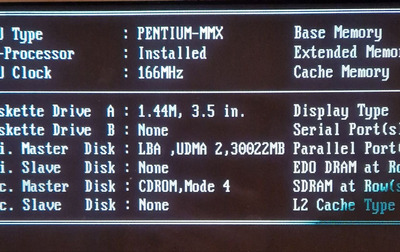

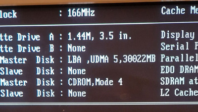

Thanks for the effort.
I've installed Intel's original chipset driver, version 3.4.0. They also install IDE Bus master driver for the south bridge.
I'm not entirely sure a whole fresh installation would change anything at this point, it might be worth a shot...
    150.58 KiB
    528 views
    1.4 original BIOS POST UDMA diciture

    174.91 KiB
    528 views
    POST UDMA status with BIOS patch
    125.83 KiB
    528 views
    Bios patched
Reply 26 of 38, by Chkcpu
Thanks for the pictures, they look exactly as they should.
Did you try uninstalling the Intel drivers, so Win98 reverts to its MS drivers?
Maybe that is all you need to avoid a clean re-install of Win98SE.
Jan
