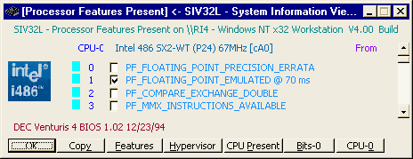

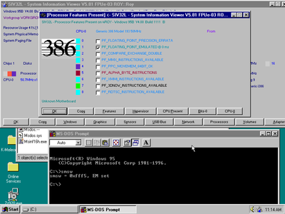

Reply 1041 of 1177, by roytam1
@red-ray I wonder if there is a way to detect if Real FPU exists in 386/486 systems?
it seems that SIV reports FPU exists on a 80387-nonexistant win95 system.
Reply 1042 of 1177, by weedeewee
roytam1 wrote on 2025-03-17, 15:42:

Reply 1044 of 1177, by red-ray
With Windows NT then SIV uses IsProcessorFeaturePresent( PF_FLOATING_POINT_EMULATED ) which works, but this is not an option on Windows 9x. As windows emulates the FPU trying a floating operation in a __try{}__except{} block won't work and the only way I can think of is to time how long FPU instructions take. I added some code to SIV 5.81 Beta-03 that does this and it works on my 486 SX2, but I don't have a 386 that I can test it on.
If you check Menu->Machine->CPU D+W Benchmark it will be pretty obvious if there is no FPU, on my Intel 486 SX2-WT (P24) it took 133.08 seconds!

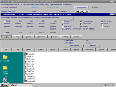

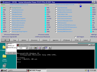

Reply 1047 of 1177, by red-ray
roytam1 wrote on 2025-04-05, 01:14:
BTW I heard that you can use SMSW instruction to get lower 16bit of CR0 register, so it can be used for checking EM bit.
Thank you for the pointer, I had a look at SMSW and read:
However, it is not a privileged instruction and can be used in application programs if CR4.UMIP = 0. It is provided for compatibility with the Intel 286 processor. Programs and procedures intended to run on IA-32 and Intel 64 processors beginning with the Intel386 processors should use the MOV CR instruction to load the machine status word.
So it will fail if CR4.UMIP != 0 and I don't know if it's possible to check CR4 in user mode. In the end I felt SIV should do SMSW in a __try()__except{} block and if there is an exception revert to the time FPU instructions take.
What happens with the attached SIV32L V5.81 FPUe-03 test SIV on your W95 i386 system? Please post screen shots of the Initial Screen and Menu->Hardware->CPU Detail->CPU Present. Ideally also do Menu->File->Save Local and post the save file.
SIV looks better in you install the Tahoma font which you can get via download/file.php?id=216286.
Reply 1048 of 1177, by roytam1
red-ray wrote on 2025-04-05, 08:50:
Thank you for the pointer, I had a look at SMSW and read: […]
sure.

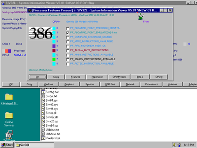

Reply 1049 of 1177, by red-ray
roytam1 wrote on 2025-04-06, 03:15:
sure.
Thank you, I see FPU is still reported, but from just the screen shots it's impossible to figure out why so I have added some code that may help.
What happens with the attached SIV32L V5.81 SMSW-03 test SIV on your W95 i386 system please? As a minimum I need screen shots of the Initial Screen, Menu->Hardware->CPUID->CPU-0 and Menu->Hardware->CPU Detail->CPU Present, to give me the best chance of figuring out what is going on do Menu->File->Save Local and post the save file. If you don't wish to post it you could PM or email it to me.
This would be almost trivial to figure out if I had an i386 without an FPU W95 system here, but I don't even have an i386 motherboard.
Reply 1050 of 1177, by roytam1
red-ray wrote on 2025-04-06, 09:01:
Thank you, I see FPU is still reported, but from just the screen shots it's impossible to figure out why so I have added some co […]
sure.
tried with your today's build:
Reply 1051 of 1177, by red-ray
roytam1 wrote on 2025-04-06, 10:22:
Thank you, I think it's got FPU correct, but I should check the save files.
I managed to get Windows 95B V4.00 Build 1111 B running on my AMD Athlon M2 (Pluto) and think I have found the root cause of many of the strange effects, it seems that GetSystemInfo() fails to setup the wProcessorLevel + wProcessorRevision members of the SYSTEM_INFO block! Depending on what happened to be there SIV may have not worked as it should so I changed the code to compensate for this Windows 95B bug.
What happens with the attached SIV32L V5.81 Tidy-03 test SIV on your W95 i386 system please? Please do Menu->File->Save Local and post, PM or email me the save file.
Looking at the 2003 documentation Windows 95 is not mentioned, but it is in the January 1999 MSDN library.
Reply 1052 of 1177, by roytam1
red-ray wrote on 2025-04-06, 10:37:
Thank you, I think it's got FPU correct, but I should check the save files. […]

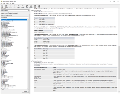

now it says differently:
If wProcessorArchitecture is PROCESSOR_ARCHITECTURE_INTEL, wProcessorLevel is defined by the CPU vendor.
from https://learn.microsoft.com/en-us/windows/win … api-system_info
tried to Save Local but the benchmarks takes very long time to benchmark.
Reply 1053 of 1177, by red-ray
roytam1 wrote on 2025-04-06, 11:49:
If there is an issue with a section then do Menu->File->Save->Save Selected and uncheck that section. It takes 136.43 Seconds on my Intel 486 SX2-WT (P24) @ 67MHz so can't you just wait?
What is the point of telling me what the current document specified when we are dealing with Windows 95? That document not even mention W9x + NT3 + NT4 and the Jan 1999 information I posted is far more relevant. Clearly when programming for old systems you need to use the old documentation which is why I have the Jan 1999 readily available on this system.

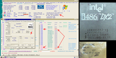

Intel i486 DX2 SX807 CPUs, two variants? I have recently been adding the i486 S-Specs panel to SIV and am wondering if there are two variants of the Intel i486 DX2 SX807. Looking at https://www.cpu-world.com/sspec/SX/SX807.html then the SX807 CPUID is listed as 0435 as does https://www.ardent-tool.com/CPU/486_Step.html, but I have a SX807 and it's CPUID 0436! So there seem to be two variants. If you have an i486 DX2 SX807 please will you post what it's stepping is.
file.php?mode=view&id=216680
Reply 1055 of 1177, by debs3759
You can probably clean off the top surface of that SX807 to find out what it really is. Looks like an obvious fake to me. IPA will probably remove the top layers of paint.
Reply 1056 of 1177, by red-ray
debs3759 wrote on 2025-04-10, 14:44:
Thank you, the consensus seems to be it's a fake and really 486DX2-50 SX954, I wonder, why did they make it a 486DX2-66 SX807 rather than a 486DX2-66 SX955 which has the same CPUID 0436 and be far less obvious?
It happily runs @ 66MHz, will post @ 80 MHz, but Windows won't start. I wonder if a 486DX2-66 SX955 will run @ 80 MHz.
I tried IPA with no luck when got my digital callipers out, the fake is 2.70 mm thick and all my other i486 are at least 2.85 mm so I expect they skimmed it then added fake markings
