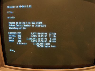

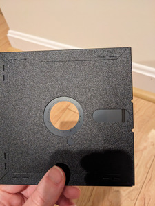

I put a 5.25 disk into a disk drive on a machine I don't use often. It read the disc initially, but when I went to run the install program on the disk, I got the typical drive read failure message. Hit retry several times but it didn't work. Popped out the disk and I notice it has very visible physical marks on it now on the center ring and along the edge (visible in the window), which seem to go the full circumference.
I tried the disk in a separate known good 5.25 drive I have and did not have any luck.
So just looking for confirmation of what I suspect, that perhaps the first drive totally gouged my disk, and there's no way to fix the disk now that it's so heavily marked?

Reply 1 of 7, by Horun
Bottom head did something to the disk. FWIW: those clamp marks tell me the disk itself was failing with aged media but the score on bottom of disk says bottom head has an issue....
just a quick observation...Yes the disk may be ruined.

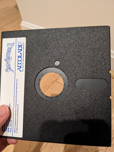

Reply 3 of 7, by dukeofurl
Well I have a semi happy ending. I figured I had nothing to lose so I went to town for the last hour or so on the disk with isa alcohol. It cleaned up the circle on the outer edge pretty well, the stuff in the center seemed like physical damage though and the alcohol didn't do anything there.
But good news is that I tested the disk anyway in my known good drive and it works again... However due to the other damage, I'll probably just retire this one to the game box forever.
After all this extra effort to try to install the game from original disks, it seems the circa 1992 installation program is incompatible with my whopping 2gb hard drive, telling me I have no space to install the game when I very much do 😆.

Reply 5 of 7, by DaveDDS
If you have the disk reading again, and a known good drive ... I suggest using something like
my IMAGEDISK tool to read it into a file so you can recreate it at any time.
If it's a simple DOS disk, you might get away with my "much simpler" XDISK tool
(The fact that they advise you to make backups means it probably is a simple DOS disk)

Reply 7 of 7, by analog_programmer
Creating an image from a physically damaged (floppy) disk isn't very good idea. If the game's user manual "tells" that you can make a copy of all the files by using COPY command and all the files on the damaged diskette are still readable, then just copy them to another diskette. If you care to preserve the original creation date & time of the files, I'm pretty sure there are some 3rd party DOS tools to copy the files without altering a new file creation date & time. Probably you can transfer the original sticker to a healthy 5.25" diskette.
