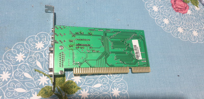

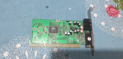

As the title says. I have a ESS Audiodrive 1869F ISA card... a rather primitive one if you will - there's barely anything, besides caps, the IC, a few SMDs at best and a TDA2025 amplifier.
The issue: sound is clipping no matter what the volume is set at. The best I can equal it to is using one of those dinky 9999-in-1 Tetris speakers as a means of outputting sound thru the speaker out jack. This happens at all sound levels, but becomes more and more noticeable past 50% Windows volume.
Is there anything I can try? Or am I better off switching to a YMF 719 or just finding another 1869F that is better built at the very least?
Of note:
- the card exhibited the same symptoms prior to recapping
- it has no jumpers for Line Out/Speaker Out
- it's built cheaply enough that NONE of the jacks in the back are marked, there's literally no marking as to which jack does what, and as such I had to guesstimate based on the other cards I have (Vibra16, YMF719, YMF724 PCI) as to which was the Speaker/Line Out jack.

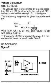

P.S. Now looking at TEA2025B datasheet, I think you can probably try to reduce the gain through Rf (R41 and R42 on the PCB) and C1 (I can't see those markings on your pictures) connected in series to feedback pins (6 and 11):

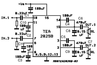

Given it sounds good now, I'll run it as it is, using the chip's own amplifier. (IIRC it has an internal amp?)
As for the reason of connecting BOOT and FEEDBACK together - the diagram I found in the TEA2025B datasheet shows them connected together with the IN and OUT pins (not counting the resistors).

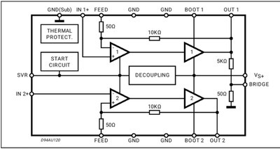

I found some statement that BOOT1/2 pins are connected to some capacitors which reducing signal distortion (probably have relation to clipping too).
Do you mean bridging FEED1 pad to OUT1 pad and FEED2 to OUT2? I couldn't understand what pads you've connected to make it finally work with amp chip removed.
Can you write out which pads are connected after the amp removal, so the circuits are now working fine i.e. pin2 (OUT2) - pin7 (IN2); pin10 (IN1) - pin15 (OUT1)... etc.?

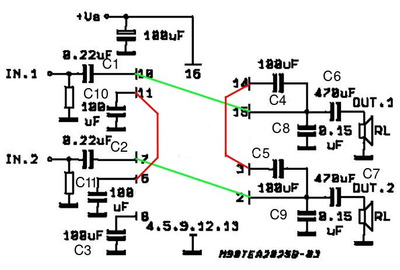

Reply 16 of 17, by PcBytes
A bit rough but here's the wiring. Blue is the IN and OUT wires, orange are the BOOT and FEED wires.
BOOT goes under the positive lead of that cap because one of the traces were likely torn when I had to remove the TEA2025B.
As for pins connected:
- pin 2 goes to pin 7 (OUT 2 connected to IN 2)
- pin 15 goes to pin 10 (OUT 1 connected to IN 1)
- pin 3 goes to pin 14 (sorta, the trace from 14 goes under the cap and since that trace broke when I removed the TEA, I just ran a wire under the positive lead of the said cap - these ard BOOT 2 and BOOT 1 tied together, as per the reference TEA2025B diagram posted earlier)
- pin 6 goes to pin 11 (FEED pins, same as with the BOOT - tied together since they are part of the same circuit BOOT and I/O wires were tied together to)

The original circuit was this:
48.08 KiB
95 views
And basically now the output circuit looks like this:
47.57 KiB
95 views
I have no explanation why the connections in red color are needed while amp chip is missing (the bridge between FEEDBACK pads 6 and 11 still seems absolutely redundant to me), except the presence of the residual connected capacitors and resistors and probably improperly selected IN-OUT bridge points. On the soundcard PCBs without installed "internal" amp out of the factory, If not all, most of these passive elements are omitted.
