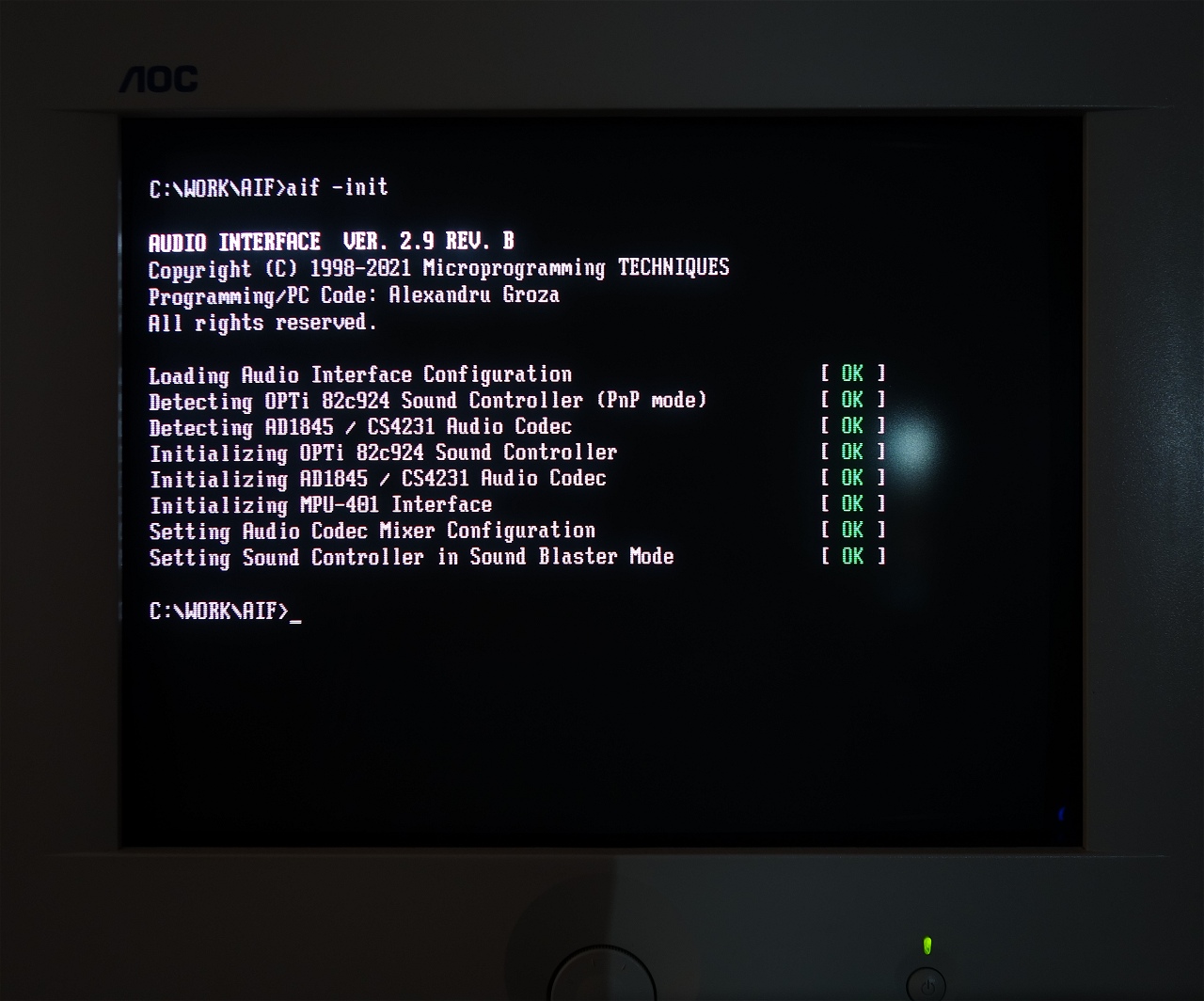

These kinds of issues are a bit hard to debug from a distance. Maybe if you could add a picture of the card? Both solder-side and component-side.
It could be anything from a soldering issue (even small solder bridges) to a defective CS4231 codec.
For some reason, on your screen capture, the codec is detected as AD1848/CS4248. Is that what you have used?
I would really recommend CS4231A as the card was constructed with that one in mind. Or if you already use AD1845 / CS4231, then this has to be selected in the AIF setup, first.
The AIF output should be very similar to:
Cheers,

Reply 18 of 22, by mbalmer
ALEKS wrote on 2025-03-25, 10:23:
So, that's what I found strange. I am using a CS4231, but the init program seems to insist on trying to look for a 4248 for some reason and it's not clear how to tell it to look for the other chip. I tried running the setup program to tell it that the 4231 was what I was using, but after running that and then running the init program again, it still insists on looking for a 4248 instead. I also noticed that there's been at least a few revisions of the software between the image you showed and the version that's on the github, so I thought it was something to do with that, but I don't know Pascal well enough to determine why the current version seems to insist on looking for the other codec chip.
As for pictures, here are some shots of the immediate region around the OPTi chip and the codec, the OPTi chip itself, and the back side where the codec's socket is mounted. I don't think the problem would be solder bridges, but who knows.
Also, you'll notice R14 is two resistors tied together in series, I freely admit that that's kind of a hacky way to get the job done but I didn't have the right value on hand.
Reply 19 of 22, by ALEKS
The soldering appears to be of very good quality, thus you're right, it's not from there.
But I have noticed that you have JP3 closed. It should be open (i.e.: no jumper set) so that the software could take control of the card. Otherwise, the card would attempt to read the EEPROM, which is empty.
That might be the issue.
