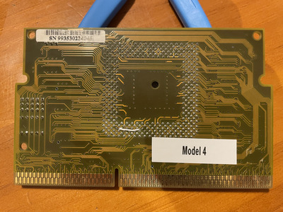

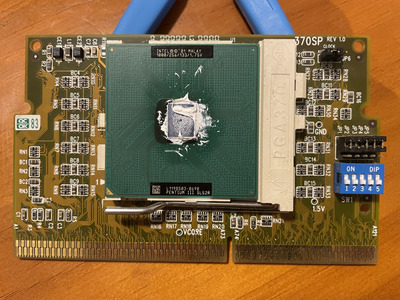

I know this is a pretty big necro, but I just wanted to say thank you to rasz_pl for suggesting the tape method. I just successfully modded a 370SP Rev 1.0 slotket using one wire and a small section of adhesive backed label in front of the grounded pin to block the connection.
Much faster and easier than removing the pin and completely reversible if necessary.

Reply 10 of 11, by NeoG_
PARKE wrote on 2025-02-11, 14:06:
Can you please post a nice close up photo of that slotket ?
Apologies I didn't see the notification, here are the pictures. I had to take it out of a working system so don't mind the thermal paste.
Reply 11 of 11, by PARKE
