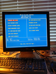

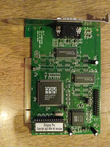

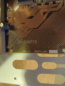

Hi everybody, I've received a computer from a family friend that I'm trying to figure out what to do with. It's a bit older than other computers I've worked with, so any help/advice would be greatly appreciated. It has a 100 MHz "Pentium-S" (that's what the BIOS says at least, I haven't removed the cooler to check the CPU itself), 81920 KB of memory, and a Gigabyte GA-586ATS Revision 2D motherboard (I couldn't find the exact revision online, but a similar revision was on the Retro Web). This seems like it could make a decent Windows 95 PC, but I've already got an Optiplex GN+ with 128 MB of memory and a 233 Pentium MMX, so I'm thinking of possibly turning this PC into a Windows 3.1 computer or perhaps a DOS PC. I've attached pictures of some of the expansion cards as well (It has a StingRay Pro ARK1000PV card, but I'm not exactly sure how many MB it is; according to DOS Days Website, it looks like the card either came with one or two MB). I guess what I'm wondering is:
1) What OS do you guys think would be best for this thing?
2) What is your experience with the hardware in this machine? Is there anything that I should be aware of?
3) I'm thinking of using a CF card to store the OS; would you guys recommend going this route, and if so, what size CF card?
4) Also, according to the board's page on The Retro Web, this motherboard supposedly has a PS/2 Mouse input, and while there are a couple of breakout cables from the motherboard that go to the I/O slots in the back (Parallel, Serial, etc), the PS/2 looking port seems a bit funky looking compared to other PS/2 ports I've seen... is that just a regular PS/2 input?
Thanks everyone,
- Rubdub

The 6-pin mini-DIN on the top bracket? That looks like a standard PS/2 mouse port.
My vote goes to DOS 6.22 and Win 3.11... I too have a P100 and it's my favorite "sound cards hosting machine" (PicoGUS + AWE64 + MT32pi). It is the perfect speed for late DOS games to.
In terms of sound card, you can get away with any sound cards you can get your hands on... There are tons of SB16 out there.
Up until Windows 95, CF or SD card are my go to. It makes file transfer sooo easy from your main computer with a cheap USB adapter. I use 8gb cards with 4 x 2GB partitions...
I agree with shamino, that looks like a standard PS/2 port... Just not green like you're probably used to seeing.

I'm not familiar with Ark cards but seems like you may have quite a fast card?
Ark Logic PCI, an interesting VGA card.
