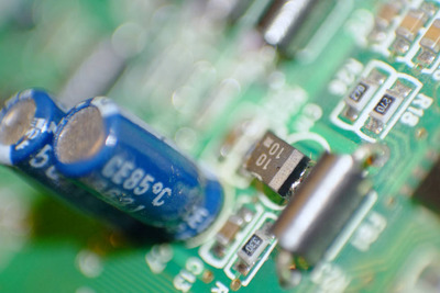

Project goal: replace wet aluminum capacitors with tantalums wherever possible.
For decades tantalum capacitors have been a premium choice for high-end products, providing extremely long life and very stable characteristics. Some people hold fears about them blowing up at random, but this isn't supported by data.

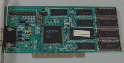

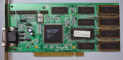

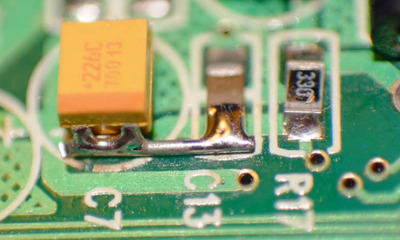

First experimental subject: cheap noname S3 ViRGE/DX graphics card. The board comes with about a dozen small alus, mainly NOVA branded. Nine 10 uF 25 V, one 22 uF 16 V, and one 1 uF 50 V, all through-hole and about 3 mm lead spacing. All appear to have 5 V across them, so 10 V tantalums should be enough. My small grab bag has some 1990s 3 mm 10 uF 10 V anyway so that's what it's getting.
The attachment 1.jpg is no longer available

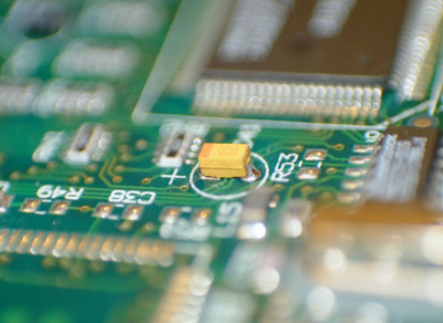

SMD on through-hole, not great but I don't have any th tantalums. The card wouldn't output anything with tantalums for the 1 uF and 22 uF, replacing the 1 uF made no difference. I didn't bother measuring the originals or replacements, besides for capacitance, so who knows. With two placeholder vintage ELNA alus the card works. 2D image quality is about as bad as it always was on this unit.
The attachment 2.jpg is no longer available
Maybe in the future I'll return to this to give it proper through-hole tantalums instead of random reused SMD ones.

Reply 1 of 51, by StriderTR
Well, at least it's working. 😀
I've got a good stock of a variety of common caps on hand for situations like this, though, I have more TH than SMD. Need to go through them one day and see what I have vs what I need.
On a side note, I see a lot of people talk about their S3 cards bad 2D quality, perhaps I'm just lucky, but the few I've used have looked and worked great. Honestly, it's probably one of my favorite DOS cards for sheer compatibility. Kinda wish I had a Voodoo 1 to use with mine in my DOS rig, but not at current prices.

Reply 2 of 51, by vvbee
I have a regular ViRGE with crisp image quality, so it's possible for sure. Only uses ceramic capacitors as well.

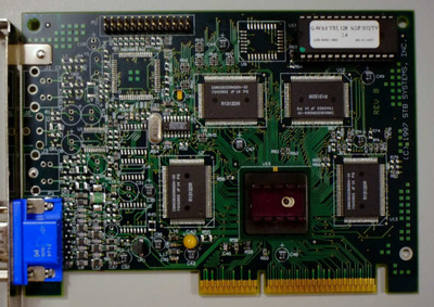

Reply 5 of 51, by vvbee
Second subject: STB Velocity 128 (RIVA 128 AGP). Again about a dozen through-hole wet alus, most 10 uF 16 V, one 22 uF 16 V, and a 47 uF 10 V through-hole tantalum. The tantalum I left in place. All removed alus measured 3-Ohm ESR and a capacitance as rated. Most Nichicon, a few T.I. My parts bag had 1990s 16 V tantalums for the 10 uF and a more modern 10 V for the 22 uF. Based on my measurements of a PCI version of the RIVA 128, some capacitors get 3 and some 5 volts across them.
Again SMD on through-hole vias, since that was god's plan.
Card works and I think 2D image quality is better.

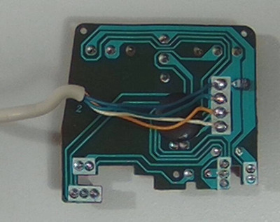

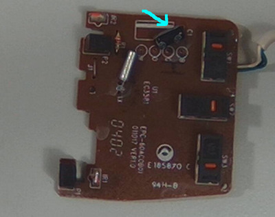

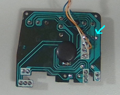

Third subject: noname serial ball mouse, apparently from 2004. It has one wet through-hole alu, 10 uF 25 V, which measures the right capacitance and an ESR of 4 Ohms. Looks to have 5 volts across it in use.
The pads are on the back. The white wire has partially lifted its pad, cord been yanked probably and all the stress went through that wire.
A 10 uF 16 V SMD tantalum went onto the pads of the capacitor. The wires had to be moved to make room, and later adjusted some more for a better angle. You could probably think about rerouting the whole cable so it exits the PCB from the side rather than the top so the white wire or one of the other ones isn't so likely to rip out entirely, but maybe some other time.
The attachment 3.jpg is no longer available
It's not a great mouse, but probably works the same now as it did before. Does work anyway.

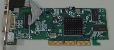

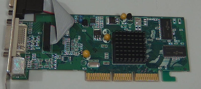

Fourth subject: Sapphire Radeon 7000. Three wet through-hole alus, 100 uF 16 V, Licon LRM. Measured the right capacitance and about 0.6-Ohm ESR. A couple of them ran with about 2 volts across them, the third one I didn't bother checking.
Got replaced with new through-hole 100 uF 16 V tantalums. Same ESR as the originals.
Card works. Image quality is unchanged, but can now be overclocked from the anemic 133/133 default. Used to artefact above 140 or so, now can do the more usual 150/150 without issue. Though this is in a different system with different software.

Revisit of the noname S3 ViRGE/DX to get rid of the two remaining wet alus that wouldn't work with tantalums. The 1 uF cap was replaced with a through-hole 1 uF 35 V tantalum, and the 22 uF one with an SMD 22 uF 16 V tantalum.
A pad was lifted and rerouted. I doubt this PCB can take many recappings, so you might as well try and do it once with tantalums.
Card works this time. 2D image quality may be better.

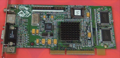

Reply 14 of 51, by vvbee
Fifth subject: ATI Rage Pro Turbo. Five SMD wet alus, 22 uF 16 V. Capacitance measured per spec, ESR of 5 Ohms. Some have 3 volts across them, some have 5, one has 12.
Replaced with four 22 uF 16 V tantalums and a 22 uF 35 V tantalum. Two of them were donated by a kind Voodoo Banshee, the rest were new.
Card works. The alus were likely not doing anything critical anyway.

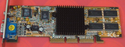

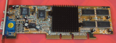

Sixth subject: SiS 315L-128. Ten wet alus: 6 47 uF (Tocon), 2 10 uF (Tocon), 1 470 uF (Tocon), 1 1000 uF (Sanyo). I didn't measure voltages across them, but the 12-volt rail looked to only go into an unpopulated fan header and maybe some other unpopulated parts. ESR on the bigger cans was about 0.3, on the smaller ones about 5 or something like that.
The <= 47 uF alus were replaced with through-hole tantalums, 47 uF 16 V and 10 uF 35 V. The two bigger cans got Panasonic FR. All unused. The Panasonics had about 0.2 ESR, the tantalums I didn't measure but probably normal.
Card works.
