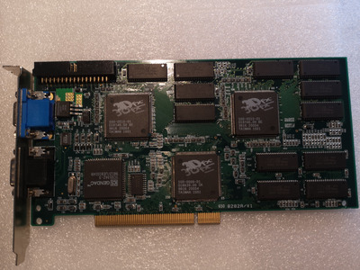

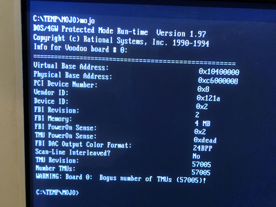

I purchased this card a few months ago for around $30 USD. From the listing picture, the corner of TMU1 was badly damaged. 3 pins completely broken off. When the card arrived I also noticed the traces around the corner of the chip had also been partially ripped off. So now it looked the repair was job was going to be a little more difficult. According to this review http://www.dansdata.com/jatonv2.htm the Jaton Voodoo 2 only had 90MHz memory chips, however the particular revision I have had 100MHz chips. I was determined to get this thing fixed.
I ran MOJO and got the following infamous error messages;
TMU PowerOn Sense: 0xdead
Bogus number of TMUs (57005)

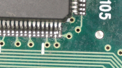

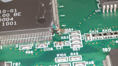

I started off with grinding away the corner of the chip to reveal the traces. I then connected some thin copper wire from those traces on TMU1 to the point where the traces were still intact on the PCB. I managed to repair the following;
56 TEX_DATA_0_4 - PCB trace repair
55 TEX_DATA_0_3 - Copper wire from chip to PCB trace
54 TEX_DATA_0_2 - Copper wire from chip to PCB trace
53 TEX_DATA_0_1 - Copper wire from chip to PCB trace
The attachment MojoBad.png is no longer available
Not the most beautiful job

After the repairs MOJO was still giving 0xDead and bogus TMUs errors. Did some hunting and found 1 bent leg and a leg that was disconnected from the PCB on TMU1.
104 TEX_DATA_1_11
103 TEX_DATA_1_10
The attachment BentLeg.JPG is no longer available
Again, MOJO gave 0xDead and bogus TMUs errors. This time set the extra logging properties before running MOJO. The new log gave me;
ERROR: non-unique g_sum=0x030
set SST_INITDEBUG_FILE=sst.log
set SSTV2_INITDEBUG_FILE=sstv2.log

I then spent many hours checking every single resistor and looked for cracked capacitors but found nothing. In hindsight, I should have checked the legs on the other chips. Sure enough the FBI had a loose leg on;
66 FB_DATA_34

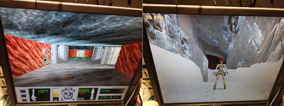

Finally MOJO was happy!
But nothing is certain until you check games.....Tomb Raider and Descent 2 are running perfectly! So happy. Another Voodoo saved.

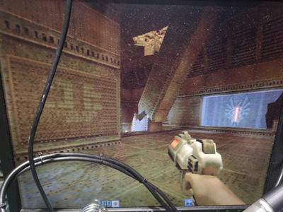

Tomb Raider - Perfect
Descent 2 - Perfect
3DMark99 - Perfect

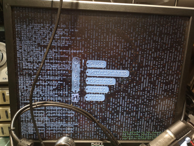

Quake 2 - Some texture issues, mainly in the menu console screen and some spotting during game play
Will post some pictures tomorrow. I’m using Fastvoodoo drivers which work fine in my Diamond cards. I doubt it’s a driver issue though. Need to do some more research.

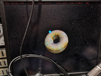

It's great to see the results of your inspiring work! Unfortunately, there are no programs that allow you to test TMU. I carefully examine the textures in the demo Donut_glide2x and look for pins torn off from the contact pads under the TMU memory chips.

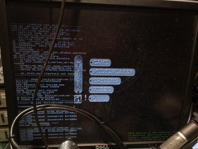

Here is what Quake 2 looks like in-game. You can hardly noticed the spots on the ground. Everything else in the game looks normal. You wouldn't really notice the issue until someone pointed it out.
The attachment Quake2.jpg is no longer available

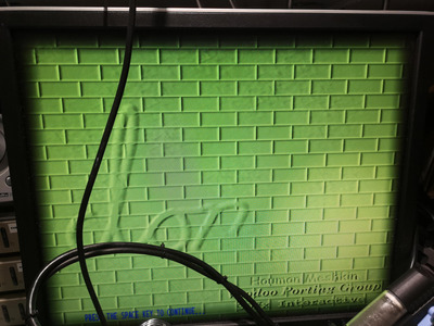

I ran set SSTV2_NUM_TMUS=1 before running Quake 2 and got the following result. All texture issues gone when set to 1. Do you know which TMU is disabled?
The attachment Before.jpg is no longer available
The attachment After.jpg is no longer available
I couldn't see any texture issues with the Donut demo? (sorry about the dust and wires on the screen. I got to sort that out 🤣)
The attachment Donut1.jpg is no longer available
The attachment Donut2.jpg is no longer available

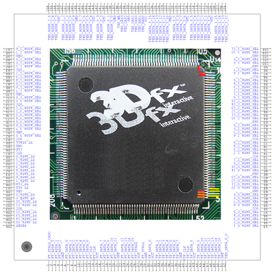

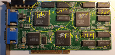

I used an IR gun to work out which TMU gets disabled when you use SSTV2_NUM_TMUS=1. TMU0 got 5c hotter than TMU1 when running timedemo's on Quake 2. So TMU1 is disabled with that variable.
The attachment Board Layout.jpeg is no longer available
I tested all the pins again on TMU1 (the TMU with all the damage) with some tweezers for movement and BINGO found the following leg disconnected from the pad. I must have missed it on my first sweep.
105 TEX_DATA_1_12
So here is a recap of what had to be repaired on TMU1
Red = Disconnected leg from PCB
Yellow = Trace repair
Orange = Had to grind down chip to reveal chip traces
The attachment 3DFX_500-0004-02_TMU.png is no longer available
I suspect the main cause of the errors in MOJO was the disconnected leg on the FBI
66 FB_DATA_34
Quake 2 is working PERFECTLY now. I ran some other games and 3dMark99 a few more times. I'm happy to call this card 100% fixed.

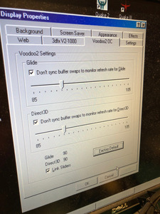

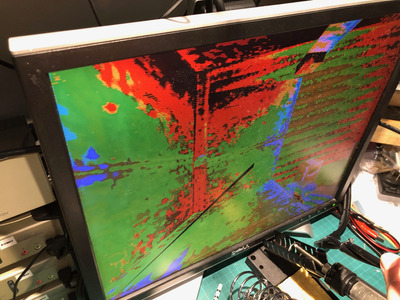

After running Quake 2 for a while, the textures started going a bit wonky. Restarted Quake 2, textures are perfect but then go wonky again after a while. I thought maybe some additional legs were loose on TMU1, so I reflowed all the legs. To my dismay, the texture issue still persisted in Quake 2. No issues in 3dMark99. Anyway, I had a think about it. Why were the textures go from working perfectly to wonky after a while. If they start off being perfect, then maybe it's not a connectivity issue between components.
The attachment Wonky.jpg is no longer available
So I had an idea....I changed the memory clock from 93MHz to 90MHz using v2oc1400.zip
The attachment v2oc1400.zip is no longer available
and now all texture issues are gone. My FPS in Quake 2 went from 52 to 51.7 so no big loss.

Sounds like the 3dfx chips on the card would benefit from active cooling.
Reply 13 of 14, by zuldan
Spark wrote on 2025-04-12, 11:04:
There is a 120mm fan blowing right on it. IR gun say TMU/FBI chips sit around 45c. I’m using FastVoodoo drivers so maybe they overclock the Voodoo by default.
Reply 14 of 14, by nali
zuldan wrote on 2025-04-12, 11:21:
I have no idea if they do.
In the 2.46 version, see FastVoodoo2_4.6/driver9x/V2-auto.inf : CmdAdd=set,"SST_GRXCLK=90"
But in FastVoodoo2_4.6/driver9x/voodoo2.inf : HKLM,"Software\3Dfx Interactive\Voodoo2\D3D","SSTV2_GRXCLK",,"93"
Fun fact : I never had any problem with the official 30202 drivers before, but with my Duron and K7T Pro 2 (KT133) Win98 freeze at boot with them.
Everything works with FastVoodoo 2.4.6.
