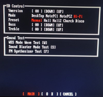

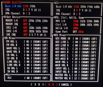

I finally got a YMF 719E-S card so I thought I'd share some of my experiences. I'm currently using the official SETUPSA.EXE from the latest Win9x driver archive (95v2343.exe) and it works well enough for my needs. As per the instructions posted by James-F, I've adjusted the SB mixer settings, disabled the 3D/bass/treble stuff and lowered the WSS master volume to 12.
First thing I noticed was that the card kept producing loud hissing noises, even with the jumper in the Line Out position and using a (known good) set of powered speakers. Turns out the initial mixer settings (set by the installer) for the WSS WAVE VOL L/R sliders were way too high. They were originally at 60 (!) and lowering them to 12 got rid of the hiss, without adversely affecting PCM volume levels.
I also realized that CD audio was too quiet in WSS mode, so I had to raise the WSS AUX1 L/R sliders to about 28 to fix that. The FM synth volume was also slightly quieter than the PCM volume at the default settings, so I had to raise the WSS AUX2 L/R sliders a bit as well.
WSS compatibility seems to be pretty good overall. I had no problems running Sierra games like Gabriel Knight and King's Quest 6 (CD versions) in WSS mode. I did notice that Space Quest 5 needed both WSS and SBPro to use IRQ 7 and DMA 1 in order to work in WSS mode, but that might be an edge case. Miles Sound System games like Heroes of Might and Magic 2 ran fine in WSS mode, as did HMI Sound System games like Descent and Tomb Raider. This is all in pure DOS. Paradoxically, I couldn't get any of these games to work in WSS mode when I ran them from within Win98. 😁

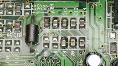

All in all, this seems like an excellent SBPro/WSS card. I may try James-F's low pass filter mod at some point, but I'm not comfortable with (de)soldering SMD components at my current skill level. Lastly, here are a few screenshots of the mixer settings which worked well for me, in case they might be useful for someone else.

BTW, can you confirm that the WSS INPUT L/R slider of SETUPSA.EXE controls the wavetable daughterboard volume, as someone mentioned earlier? I don't have one to test this myself, as my MIDI gear is all external.
Reply 203 of 221, by Tiido
I cannot confirm that, I don't have any hardware available to me to test with right now, and besides I use my SETYMF util instead of SETUPSA 😜
It should be AUX1 or AUX2 though, one is CD, other is WB+FM.
This is well worth the risk IMO, it brings the SB Pro sounds of this card to life. It's not too hard but is possible to lift the pads.

After practicing for a bit, I got confident enough to try the mod today, and I'm pleased to report that it was successful! Not very pretty to look at, but fully functional. 😁
Huge thanks to James-F for all the research he's done on this topic!

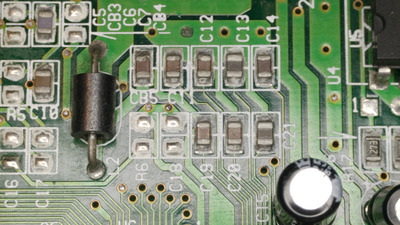

Finally got round to modding my Yamaha Audician 32 Plus (YMF719) and disabling the amp. Loving the improved sound. Thank you James!
1.01 MiB
226 views
1008.04 KiB
226 views
Used the capacitors https://au.mouser.com/ProductDetail/80-C0805C682F4HACTU

analog_programmer wrote on 2025-04-14, 08:00:
Can you give us some simple diagram or some brief explanation with pictures (before/after) for the amp disabling modification?
I just used the jumpers which just changes the output from Speaker Out to Line Out. The only physical mod to the card was the capacitor swap out.
