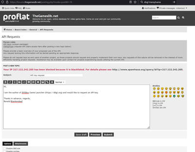

Reply 2110 of 2194, by rcblanke
RedTony wrote on 2025-04-14, 22:35:
Maybe time to swap to TheGamesDb?
DBGL supported TheGamesDB for a while, until they changed their website and API. I'm now trying to request a new key for the API, but apparently my IP got blacklisted somehow. Using a VPN results in the same 'blacklisted' error message. Not sure what to do...?
EDIT: I've sent a message to the site administrator, let's see what happens next...
