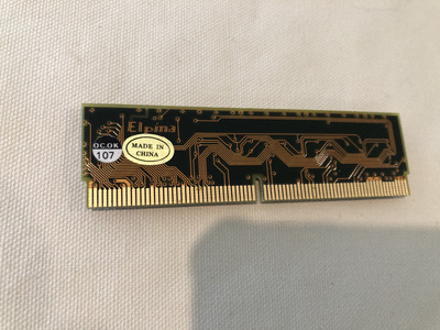

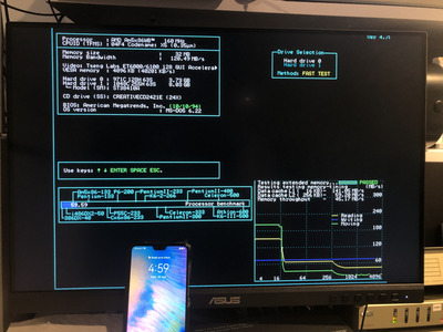

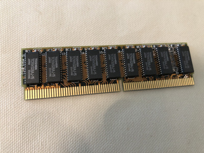

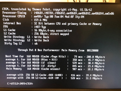

I managed to get an original cache chip for my M919 Rev 3.2. I installed the cache (cleaned all contacts prior) , the machine booted up and 256kb cache was detected on the BIOS boot screen. However, the cache isn’t used. I’ve run CTCM and Speedsys, both don’t use the cache. I immediately thought I must have EDO ram installed. So I tried another 17x memory sticks. None of them helped with the issue. Does anyone have any ideas what the issue may be?
The motherboard is using BIOS version “Release 11/08/1995“ with a 5X86 P75 133. I’m contemplating flashing a Rev 3.4 BIOS to see if that helps. The other possibility is that the cache stick might be 5v?

Reply 3 of 12, by bertrammatrix
Both of my 919s have displayed this behavior at one point or another while messing with them. The 919 first detects a module, and reports the capacity. Not untill AFTER that point does it do a check on that module. If it fails for whatever reason, it often seems to"silently " disable it in subsequent boots without indicating this in any way
Try: boot with module installed. Enter bios, disable external cache. Save and exit. Shut system down, remove module. Start system without module, let it complete post. Shut down. Reinstall module. Power on, go in to bios and enable external cache. Disable any automatic cache speed setting and just try the slowest. Save and exit. Let it complete post, and see if it works now. If it is stubborn, try to combine the above with swapping ram in to a different slot.
Note: if cache speed is set "too slow" compared to ram the board may ignore it. If this is the case then bumping up the cache speed should make it show up in tests.

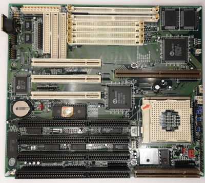

Reply 4 of 12, by feipoa
I currently own three M919 v3.4 B/F motherboards and one of the boards exhibits the issue noted above. My tests confirmed that the issue was unrelated to the cache module, the RAM, or the CPU because I switched over the same parts on all 3 boards. My two primary theories are,
1) some contacts on the cache socket are bad/intermittent, although when I peer inside with 10x magnification and a torchlight, the contacts look fine.
2) there's a via at, near, or around the cache socket which has an intermittent connection.
These are my two main theories because if I remove the cache socket, then move it in and out vigorously for 10 seconds, this seems to get the job done. Until the next day, after letting it rest a day or two, I have to do the ole in-and-out all over again.
Given how flimsy and thin PC Chips mainboards are, and how much force is required to move the cache module in and out, I'm a more inclined to believe there's a bad/intermittent via or joint somewhere near the cache slot. To further backup this claim, this motherboard also had an issue whereby the jumper that controls L1: WB/WT wasn't sending the WB/WT' signal to the CPU. Am5x86 was always in L1:WT mode. All the traces looked fine and I reflowed some joints, but I ultimately had to jumper a wire from the appropriate motherboard jumper to the WB/WT' on the CPU to fix the issue.
I have tried reflowing the entire cache slot, but this did not help the issue. The problem being intermittent makes testing more challenging. It was for this reason that I ultimately acquired a 3rd M919 (its a spare part for my Am5x86-180 system).
Reply 5 of 12, by zuldan
Thank you to both bertrammatrix and feipoa.
I removed the cache stick multiple times and used contact cleaner. No luck. I then did the following;
1. Removed the cache stick
2. Removed the battery
3. Set the CMOS power discharge jumper for 20 seconds the set it back again.
4. Reinstalled the battery
5. Powered on the machine, CMOS error appeared (because of previous CMOS discharge / no battery)
6. Entered BIOS setup

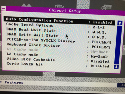

7. Disabled the External cache
8. Disabled the auto config for memory settings and set slowest settings
9. Saved settings and booted into DOS
10. Power off the machine
11. Installed cache stick
12. Power on the machine and entered BIOS settings immediately
13. Enabled External cache
14. Saved settings and booted into DOS
BINGO, cache is now working. Woohoo!!!
I suspect there is some hidden cache configuration that is only set on a total BIOS reset.

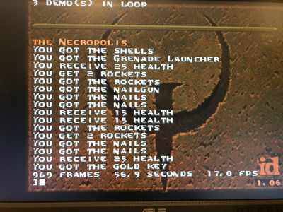

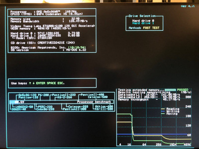

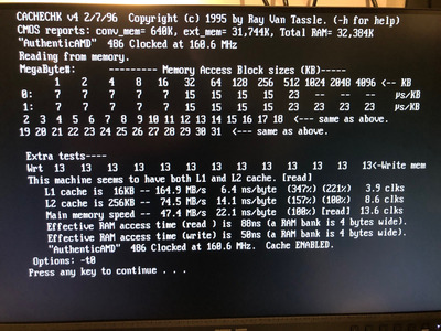

I then maxed the memory settings and did some benchmarks.
1.14 MiB
304 views
I'm now in the Quake 17 FPS club 😉

Reply 6 of 12, by feipoa
Without removing the cache stick, wait a few days and see if the cache is still working. I have a strong feeling that we haven't heard the last of this issue.

Reply 8 of 12, by feipoa
feipoa wrote on 2025-04-22, 13:27:
It's been a week. Does it still work (without removing/reinserting cache stick)?
Reply 9 of 12, by zuldan
feipoa wrote on 2025-04-30, 06:48:
Let me test, give me 5 min
Reply 10 of 12, by zuldan
Working like just out of the factory!
Maybe revision 3.2 of this motherboard behaves differently?
