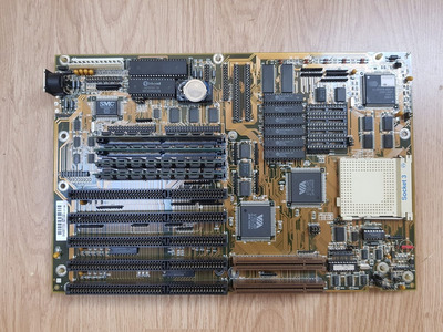

Hi folks,
About three weeks ago i brought two machines for cheap, a 386SX and a 486 machine. This machine came with a FIC 486 VAV REV A board with a 486DX-33, 128 KB cache and a Seagate 2 GB hdd.
I've been digging around on the net and found that this seems to be a low end but highly integrated board, it has onboard ide , fdd, and Video (Cirrus Logic GD5428 which is very decent and is sitting on the local bus).
The first thing i did was fixing the RTC issue by adding the coin battery mod, then updated AMI BIOS from 1.025 to 1.026A version and upgraded the ram from 4 to 16 MB. The bios was very limited and i thought by updating it would unlock some hidden features but still there are no ram timings nor BUS options for tweaking, so had to investigate a bit and found the AMISETUP software for enabling hidden features. Used to tweak it a little more but the results were small, still no settings for tweaking the timings or bus speed.

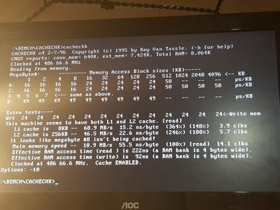

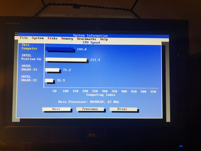

Later i overclocked the Intel 486DX-33 to 40 Mhz, the perfomance gain was ok but doom was still very choppy so i tested with different CPUs that i had at hand, a Cyrix 486DX2-50, Am486SX2-50 and a 3V Am486DX2-66NV8T which sadly i could not use because the motherboard does not support 3v CPUs. Anyways i plan to order a Socket Blaster PCB in the future.
The Cyrix one was out the game, slow and bad overclocker so i used the Am486SX2-50 oc'd to 66 with no issues.

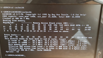

And talking about memory perfomance, at 66 Mhz CACHECHK reports 17.1 MB/s which that from my little knowledge is hmm, meh i guess, i don't know. However this board has the VIA VL82C495 and VL82C481 Chipset which is known for having cache and memory perfomance issues.

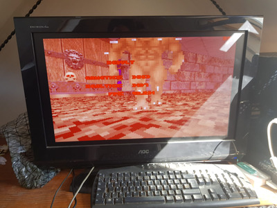

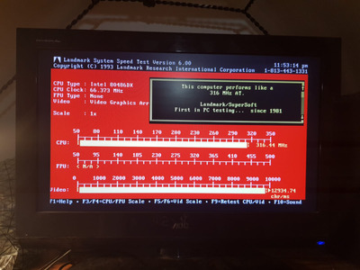

Hi, a little update.
I upgraded cache to 256 KB, ordered 10 UMC 32x8k two weeks ago. The perfomance increase was not much but noticeable, it feels snappier. CPU score was mostly the same, speedsys reported 24.4 pts and topbench an overall of 205 (no changes at all).
On FastDoom 1.13 benchmark i get 34.5 FPS avg.
LM60 - 316 MHz AT
3DBench - 45.4 FPS

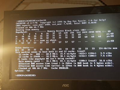

Reply 4 of 21, by jakethompson1
Your Cachechk scores for internal and external cache are in line with a fully tuned 486DX2-66 system. However, the memory speed is bad.
Something you can do is temporarily disable external cache, and run Cachechk again. If the memory scores improve, it's an Always Dirty issue (should not be an issue on this board). If they don't, it's untuned RAM wait states.
There is a FIC 4386-VC-HD BIOS with many more options, but I don't know if it would be compatible with your board.

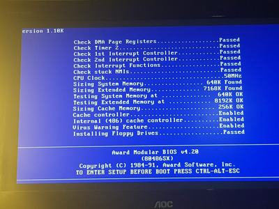

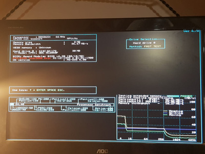

Reply 10 of 21, by bloodbath2you

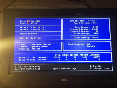

Ok, tried with a different bios from this board:
https://theretroweb.com/motherboards/s/fic-486-vc-hd#bios
it has both ami and award, tested the award one, version 1.10K, first with the GD5428 + Award bios it worked but got no video, maybe the original ami bios sets the onboard video on boot. So, i picked up a crappy 8 bit VGA card for video output and did some perfomance measures.
As you can see, the award one is even worse, feels older and more basic than the ami one, no auto HDD detection, no rom shadowing options, no fast a20 gate... it has a cache speed option btw, tried with two of three options, NORMAL and TURBO.
Turbo:
Cachechk reports 18.9 MB/s memory speed,
Speedsys reports 44.20 MB/s memory bandwidth
Normal:
CACHECHK reports 16.6 MB/ memory speeds
Speedsys reports 36.67 MB/s memory bandwidth
Topbench reported 60 something points comparable to a 386DX40 machine but is due to the bad video card so is understandable, after all i had no expectations on this bios. I think i'm reaching a ceiling but i'd try hacking the AMI bios in future and any suggestions will be very appreciated.

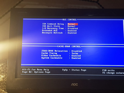

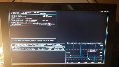

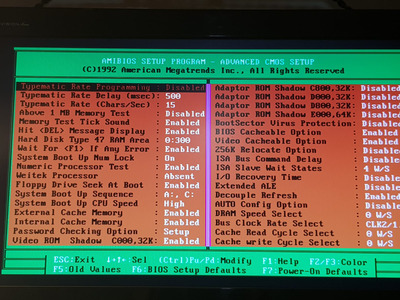

Found it! Found a good bios. Taken from this board:
BIOS 1.021
Has all options i need
- Bus speed options
- Cache timings
- Memory timings
Made a new rom with the latest Cirrus Logic bios CL-GD542X Bios v1.41 + Version 1.021 and worked perfectly.

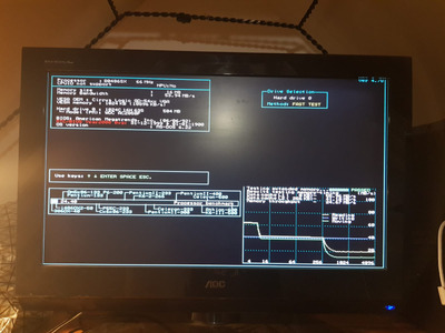

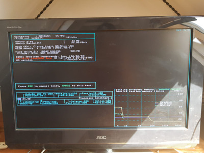

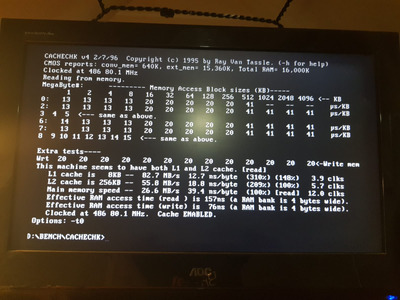

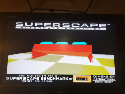

Set all memory and cache timings to the fastest , AUTOCONFIG disabled and did some measures. Also tried at 40 MHz fsb which, with the latest bios the board won't even post, crazy.
At 33 FSB, max memory and cache settings.

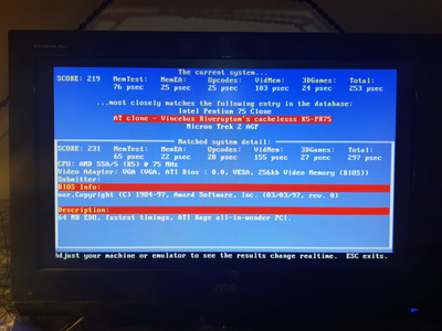

TOPBENCH - 219 score
SPEEDSYS - 53.94MB/s memory bandwidth, 24.67 MB/s troughput
LM60 - 316 MHz AT
DOOM -35.5 FPS
3DBENCH - 50 FPS
CACHECHK - 22.2 MB/s main memory speed
At 40 FSB, max memory and cache settings.
TOPBENCH - 257 score
SPEEDSYS - 65.7 MB/s memory bandwidth, 29.78 MB/s troughput
LM60 - 380 MHz AT
DOOM - *CRASH*

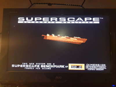

3DBENCH - 58.8FPS
CACHECHK - 26.6 MB/s main memory speed
It was stable until ran doom, duke3d runs and is playable for 20 mins until crashes. Maybe i'll mod the board and add more bypass caps around the CPU socket for reducing the current noise.

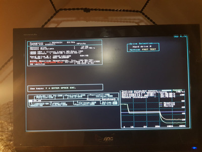

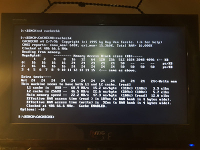

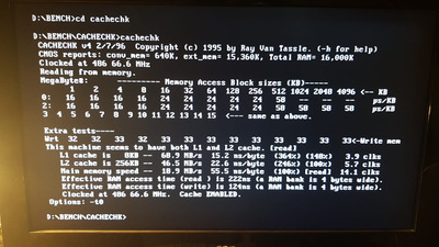

Reply 14 of 21, by bloodbath2you
captures

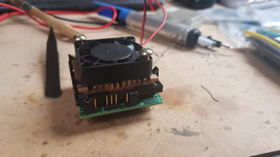

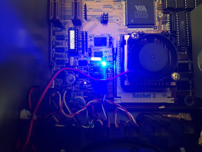

Reply 18 of 21, by bloodbath2you

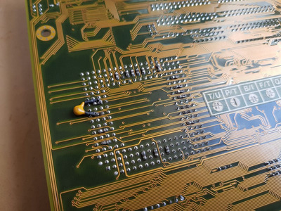

Update: Added a bunch of bypass capacitors on the socket for a total of ~36uF, 18 x150nF and one 10 uF.
FDoom now is stable and got 42 FPS at 40 MHz FSB.
Reply 19 of 21, by bloodbath2you

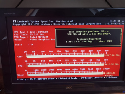

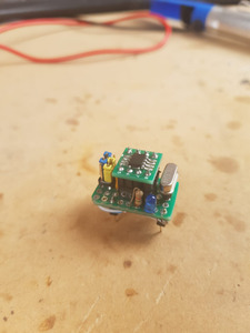

Update:
- Built a 486 Socketblaster + Intel DX4WB
- Built a custom PLL
The custom PLL based on the ICS501 LOCO made able to play with weird clocks, using a 16.9344 MHz base clock.
- 42.5 FSB 2x Multiplier : Stable
- 42.5 FSB 3x Multiplier: POSTED but very unstable.
- 45 FSB 2x Multiplier: This one is the most i tinkered with, felt very stable giving 90 MHz
TOPBENCH : 300 Pts
3DBENCH - 66.6 FPS
- 45 FSB 3x : No past post, i think it needs more CPU voltage.
- 50 FSB: No video.
All tests were on 3.78 VCORE, for overclocking i think is the max this CPU could handle.
Anyways, the socketbaster is not complete yet, i need to solder the missing SMD capcitors on the bottom. This could be a big difference on stability.
I'll post more measures if you are interested, i did everything on a run this moring, even the custom PLL so many tests were not done.
