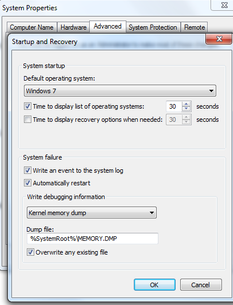

I can't find any minidump, its empty. Just to be clear, Windows didn't crash, the GfxUi program aka the Control Panel crashed. It created an xml error in Temp folder although it doesn't say much

Ok, do you have dumps disabled? Kernelbase is what handles making the dump files.
It is in the same control panel where you name the system, set the page field, etc
Sysdm.cpl

Reply 13 of 19, by BEEN_Nath_58
cyclone3d wrote on 2025-04-24, 22:04:
Ok, do you have dumps disabled? Kernelbase is what handles making the dump files. […]
Sysdm.cpl
This is what I had enabled
Reply 14 of 19, by cyclone3d
Ok, weird that it didn't output a minidump. I would recommend uninstalling the driver and then get rid of the leftover files as well as the .dll files you manually copied over.
Reboot and then reinstall the driver from scratch.
