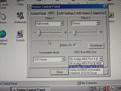

Do these cards have the ability to select any Windows MIDI device listed in the Win9x multimedia options (e.g. YAMAHA SXG Driver) as a selection in the card control panel's "DOS Box MIDI Out" section?
If this is true, softsynths that were indicated as being for Win9x apps only can now be used for DOS apps, accessed via standard MPU ports.

I probably was the one people were thinking about it being mentioned before. I haven't tried with a softsynth, but my Win98 build has an Audigy and Vortex 2 in it.
In the DOS Windows MIDI settings I could choose the Vortex 2 MIDI, Audigy Synth, or Audigy External MIDI Port.
I'll have to find some time and install the Yamaha MIDI driver off FFVIII and see what's listed.
Edit: I should add that SoundFonts worked fine with DOS games with the Audigy.

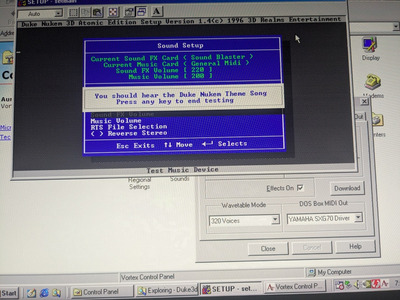

I found some time, and discovered FFVIII had just the update. So I had to also break out FFVII to install the original version and then the update.
But it does appear in the Aureal control panel, the only issue I found was the dropbox won't scroll with a scroll wheel. It also doesn't show a scrollbar, I just had to use the keyboard to scroll the the much longer list that just the four items it displays at a time. The Yamaha Softsynth is shown and works just fine in DOS.
I found if you can run the DOS game windowed, you can switch the MIDI device on the fly. MIDI only plays while the DOS window has focus. But I tested the Yamaha Softsynth vs the SB Audigy Softwavetable vs the Vortex Wavetable in the Duke3D setup and all three sounded different so the selector was doing its job.
