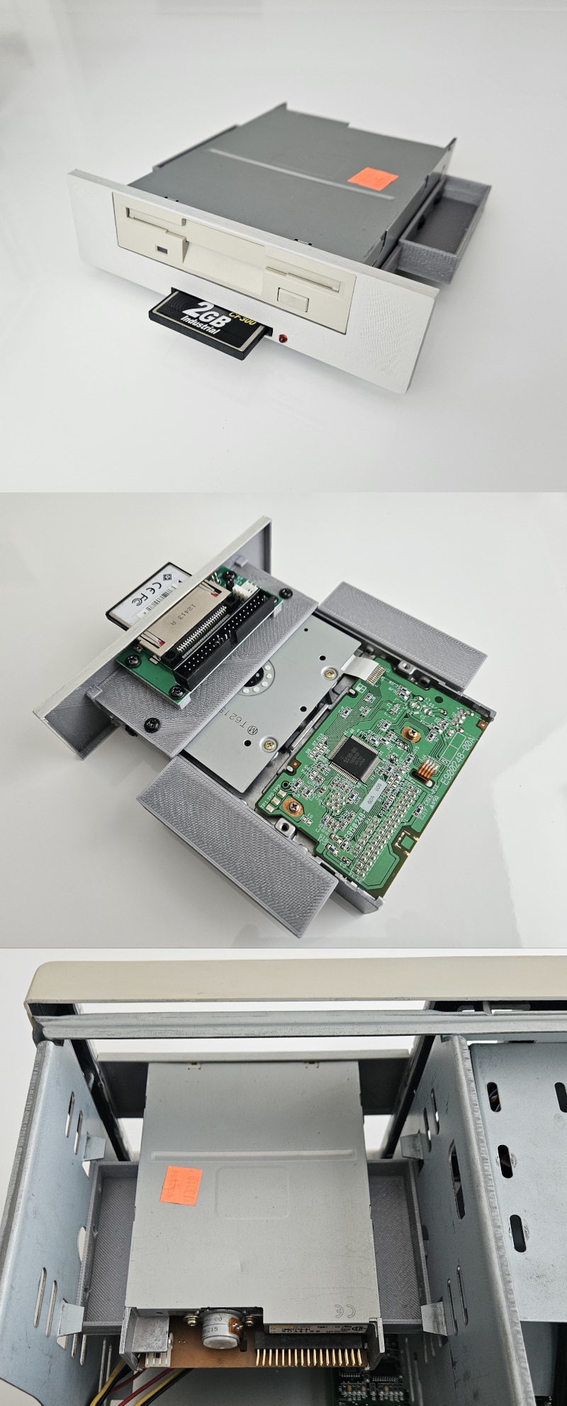

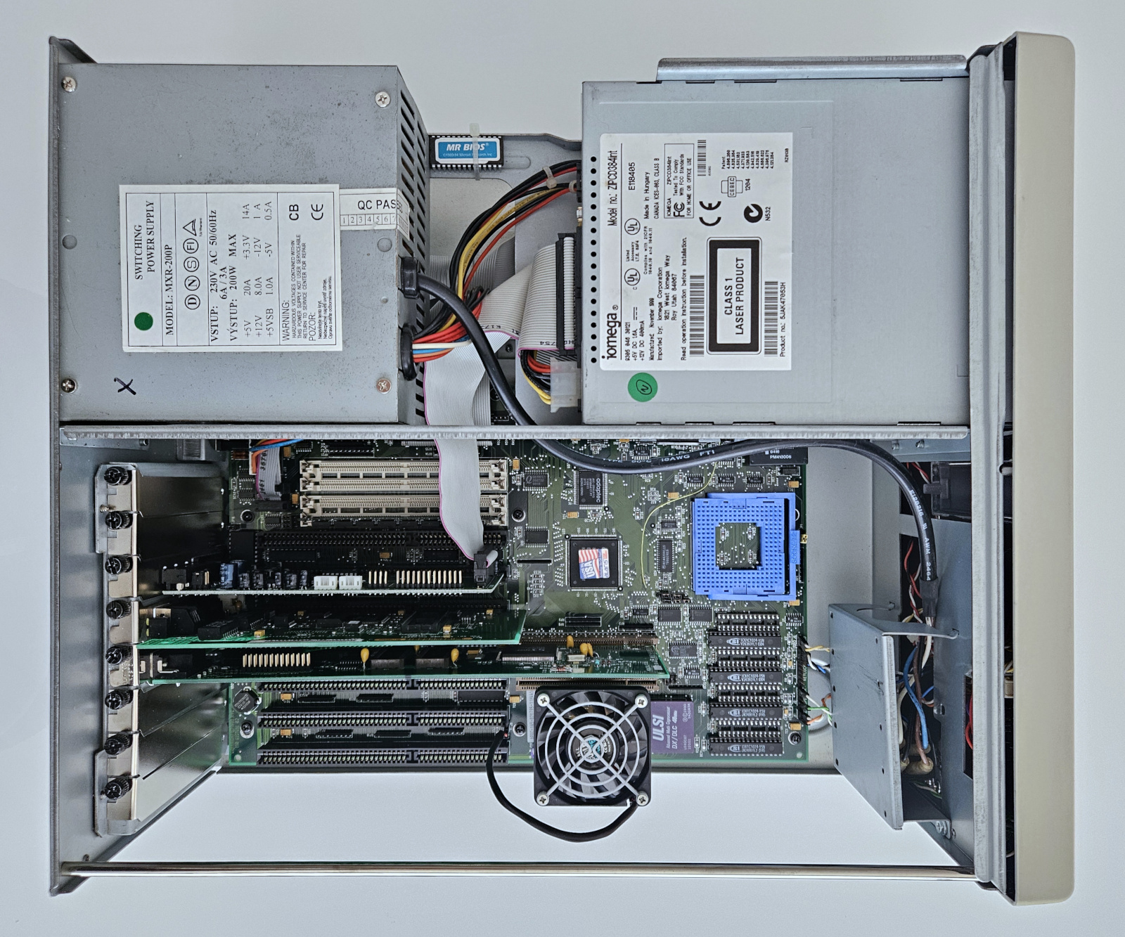

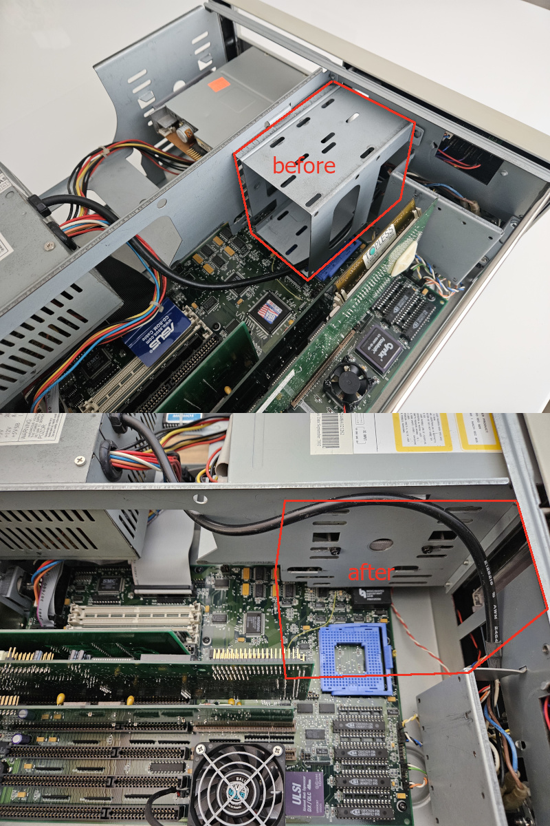

My initial plan was to place the CF-IDE adapter at the back of the case, but i realized that with a single IDE connector only th […]
My initial plan was to place the CF-IDE adapter at the back of the case, but i realized that with a single IDE connector only the cable will not be long enough to reach the 3 contact points - middle of the case the on-board IDE connector, the CF-IDE adapter on the back and the CDRW drive in the front. Additionally i wanted to remove the 3.5" floppy bay as it obscured too much from the motherboard.
To resolve these issues, I designed a custom 3D-printed mounting bracket that accommodates the optical drive, floppy drive, and CF-IDE adapter in a single consolidated arrangement. This integrated assembly fits neatly into the 5.25-inch drive bay positioned adjacent to the optical drive, reducing the cable clutter.
And this is how the computer ended up looking on the inside:
Any chance, you'd be willing to share the STL for that floppy/CF mount? And maybe even the source?

@H3nrik V!
Attached the OBJ file. It is one of the most portable 3D formats. You can work it out from there.
Thanks a lot!
