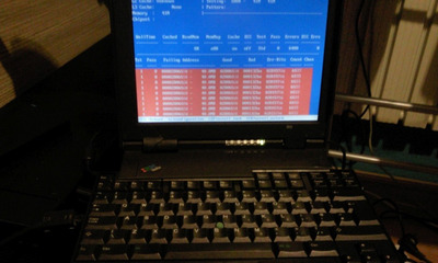

Hi! I own an IBM Thinkpad 701C Butterfly, which integrated 8MB RAM is faulty. Is there a program under DOS to skip it, so it will only use the installed memory module? Thanks!

AFAIK, there isn't, but considering it's a 486, I'm fairly certain that fixing the memory by replacing the chips, or simply removing the onboard memory should be easy enough.

Could you post a better photo of the memtest output, the one you already posted is a bit blurry.
edit: oh and btw, the last post of this thread seems to indicate that removing the onboard memory and using the memory slot does work.
https://forum.thinkpads.com/viewtopic.php?t=115762

OMG you were right!!!! Thanks for the info, I didn't find this forum! I'll take the mainboard to a professional technician and have the integrated chips desoldered.
BTW the image is blurry because it was taken in 2012 and hasn't been working ever since. I took it apart a few years ago and now decided to repair it. I'm not in a hurry :D
