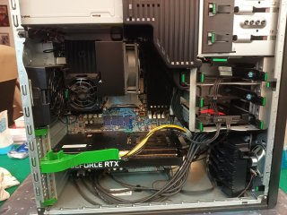

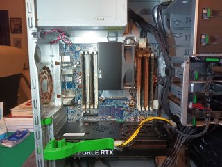

This is what it looked like when the side panel was opened: very solid - note the air ducts and fan over the RAM, the stock HP air cooler (not the liquid model, manufactured by HP itself), the full-length graphics card, and the fans. 92mm in/out of the case, with their mounts:
i.php?c=X7qCOEJ0VA&thumb=1
i.php?c=JJuMRYUoHQ&thumb=1

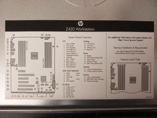

In addition to the excellent 0.022-micron Ivy Bridge processor for Socket 2011 - despite the 130W of max power consumption - from 12 cores and 24 threads, minimum clock @2.5GHz and max @3.3GHz, 3MB of L2 cache and 30MB of L3, my choice came down to the existing video card, given that when it comes to using AI models it is the power of the GPU and the video memory that are the masters: in this case the pre-installed card is decent, as are the 12GB of VRAM, even if having 16GB would have offered more leeway. In any case, I didn't want quantities of VRAM lower than these levels, without breaking the bank (which I have burned anyway, between this and the updates, etc.).
The ventilation ducts are easily removed:

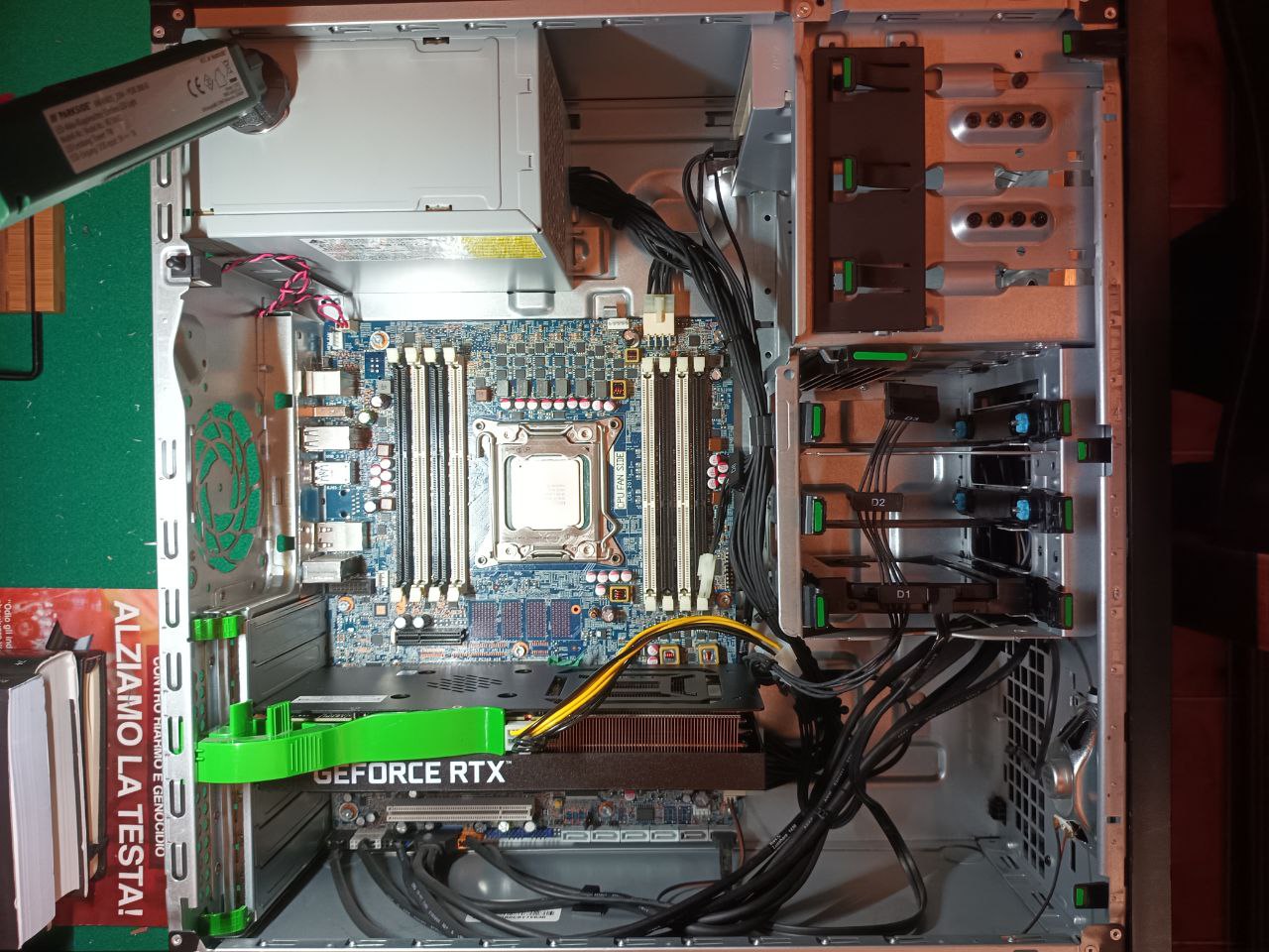

And here the stock HP heatsink was removed, and the surface of the case was given a good clean. CPU:
i.php?c=_5J7EQq-ag&thumb=1
i.php?c=3-mLna381w&thumb=1
Now all that's left to do is be patient and wait for the other components to arrive, so we can update the machine and make it as efficient as possible for the purpose.
