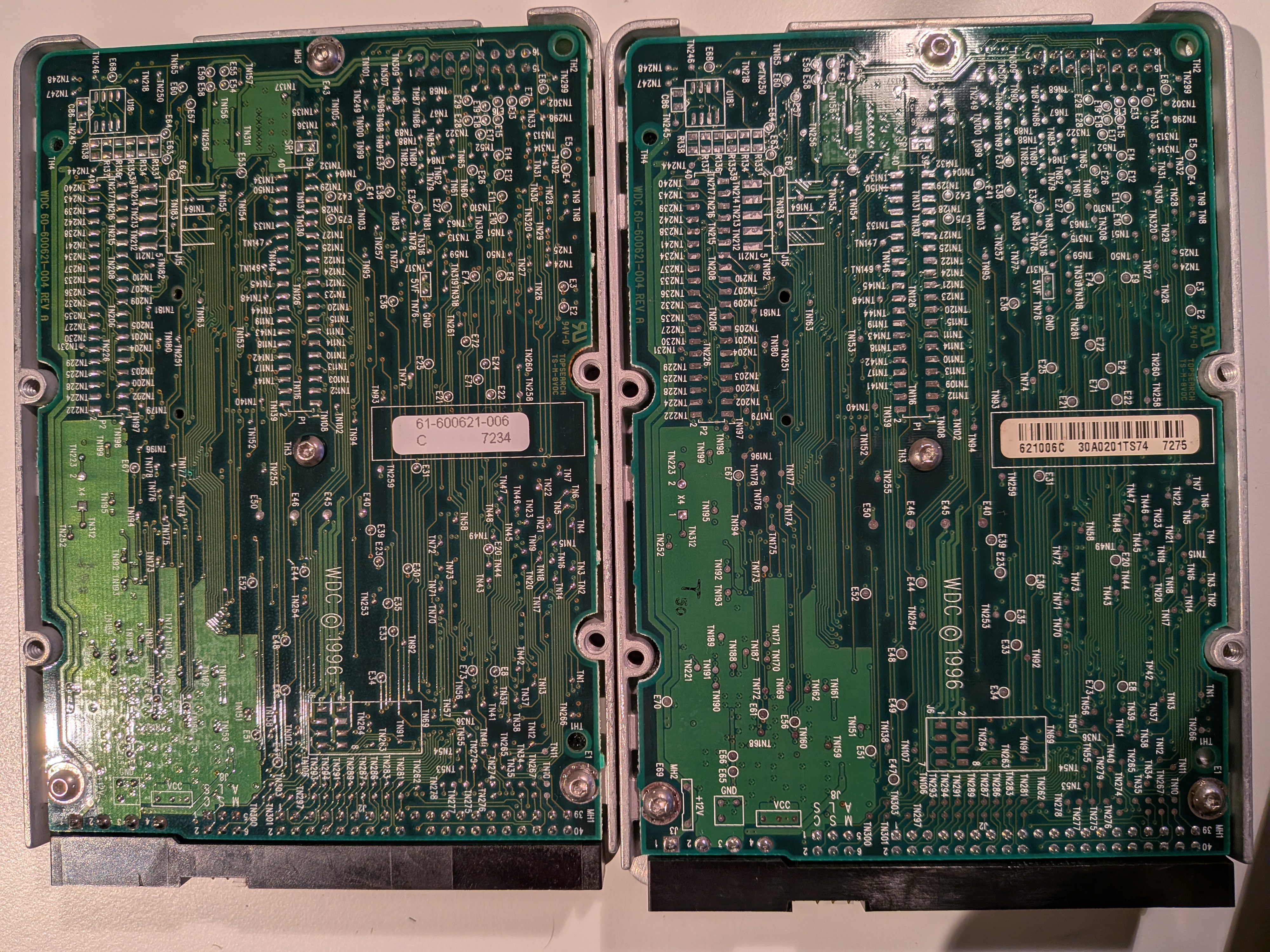

Rubix wrote on 2026-01-27, 19:02:
The drive does spin up, but then can't initialize properly. […]
Ozzuneoj wrote on 2026-01-27, 16:04:
Forgot to mention, can you post pictures of the PCB from the hard drive that is not working? If possible remove it from the drive so we can see both sides.
Sure:
Sorry, this is a bit late, but... those two boards look identical to me. They have the same PCB model.
Have you had a chance to back up the data on the working drive yet? There is a very good possibility that swapping the board from the working one to the non-working one will at least get you a step closer to reading it.
