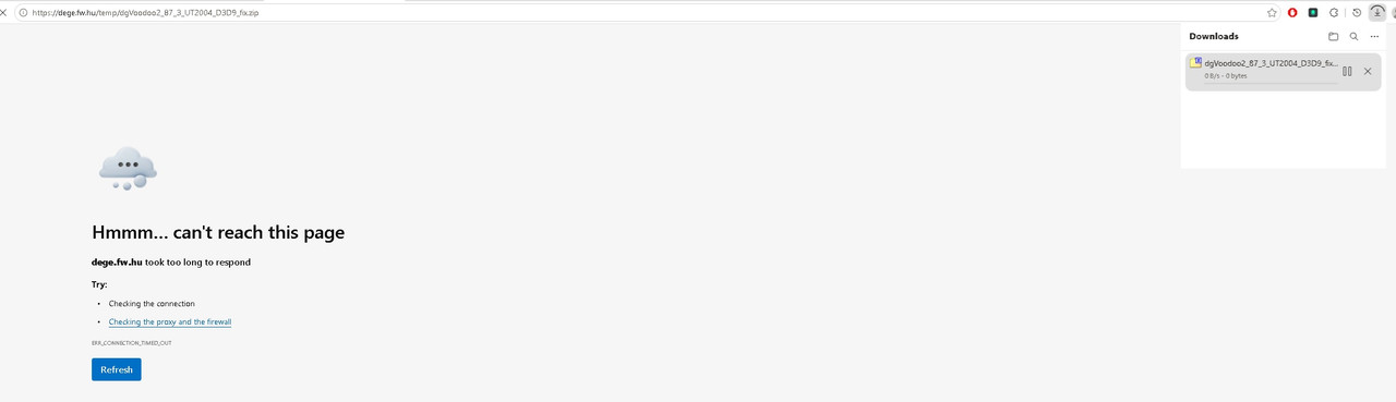

https://i.postimg.cc/vHpqWpr4/Untitled.jpg
The same using a download manager like JDownloader
Reply 5 of 5, by Dege
Weird. Then I attach it here, I'll delete it later.
