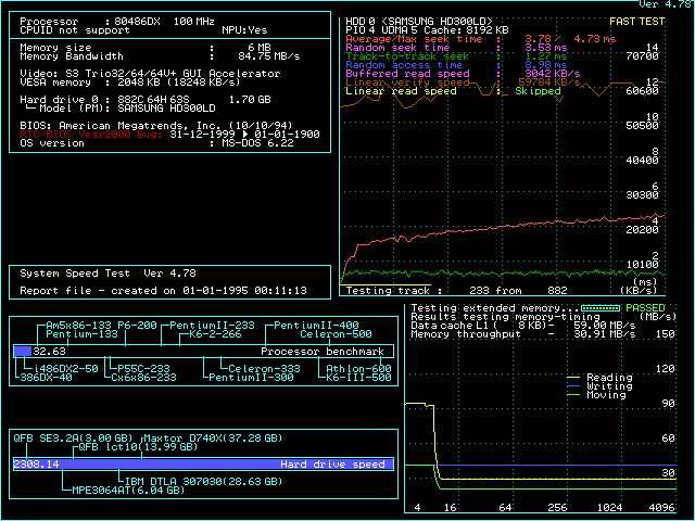

My "new" 486 board just arrived, and unfortunately the cache chips (which look a bit plasticky) are soldered on to the board.
I don't know whether to laugh or cry. I mean, I am now the "proud" owner of the infamous PC Chips fake cache board. Perhaps it's a "bit of history", and I should be pleased with my purchase.
I'll fire it up later, and post some speedsys results.
Reply 1 of 12, by retro games 100
Speedsys score of 32 seems reasonable for an AMD DX4 100 (non enhanced), but Doom looks really choppy.

Reply 6 of 12, by retro games 100
Hehe, this board is so bad, it runs Wing Commander 1 at the right speed - with the AMD DX4-100 CPU in it! I disabled L1 cache in the BIOS. (No need to disable L2 cache. 😉 ) I also set the board's Turbo button to Off. Seriously, WC1 looks and plays correctly. Speedsys.exe gives me a score of 5.79, which is exactly on the 386DX-40 "marker line".
Other "benefits" this board offers: you can plug a CD-ROM drive in to the secondary IDE port. I'm not too sure how many 486 boards allow that. I was impressed.
IMHO, if it wasn't for the 'fraudulent' fake cache chips (on my specific V1.2A board), I think this would make a nice mobo.

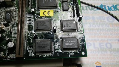

Reply 9 of 12, by Carlos S. M.
I think i found a PCChips Pentium board with fake cache as well
The board is a PCChips M507 (Intel 430FX)
    2.07 MiB
    2040 views
Reply 10 of 12, by stamasd
Those chips aren't connected to anything. 😀 At least it has a COAST slot; unless it's one of those proprietary slots for which finding a matching module is harder than finding a snowflake in hell.

Reply 11 of 12, by Carlos S. M.
stamasd wrote:
Is a COAST slot, i got that board for free a while ago with a Pentium 100 and a COAST stick attached
