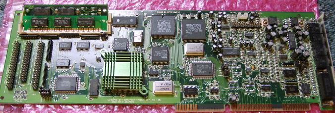

I spotted this AWE32 CT2760 on ebay, and bid on it because the unusual addition just made me curious. Bidding started and ended at 1 Euro. When I get it, do you think I should add a fan to that heatsink? 😉

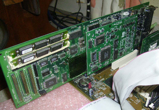

Reply 9 of 59, by retro games 100
It's just arrived, and I've installed it in a Win95 box. It works, but it's such a pity about the infamous hanging note problem - I tested Doom with a Roland SCB-7 daughterboard, and within a minute or so I could hear a stuck note. Regarding the heatsink, I pressed my fingers against it while it was playing Doom, and I could barely feel any heat on the heatsink, but perhaps I need to leave it on for much longer before it heats up?
The top SIMM holder is broken, but I've managed to push on a SIMM anyway. Seems to stick OK. The Win95 hardware auto detect feature locked up first time, but worked second time. The resources allocated were "all over the place", so I manually set them to the typical 5,1,5,330,620 settings.
Reply 11 of 59, by retro games 100
I kinda like it! It's, um, unique! 😀 It just touches the wavetable daughterboard, so it's dual purpose really - a special heatsink and nifty DB stopper. 🤣

Reply 13 of 59, by 5u3
EMU8K chips can get pretty hot, especially if you have plenty of RAM installed. Looks like the previous owner glued an old northbridge heatsink on top of it.
Regarding the "DB stopper" feature: Make sure the heatsink doesn't short something on the DB!
Reply 14 of 59, by prophase_j
If you decide you want to remove it a quick stay in the freezer will make the glue brittle and it should pop right off (assuming they didn't use epoxy or some other form of overkill).

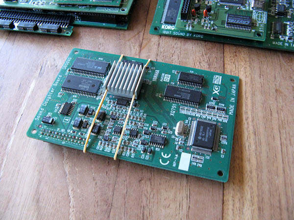

Reply 16 of 59, by Amigaz
gerwin wrote:
Yesterday I installed my DB50XG again, and noticed one of the chips was really getting very hot in little time. Now guess what I did... 😉
You put the motherload of waterblock on it to cool it? 😳 😁
My retro computer stuff: https://lychee.jjserver.net/#16136303902327
Reply 17 of 59, by gerwin
Amigaz wrote:
Almost; I wil try to run the system submerged in the bath tub 😉
But for the time being, I happened to find the cutest little heatsink 😀
    90.21 KiB
    2462 views
    DB50XG
